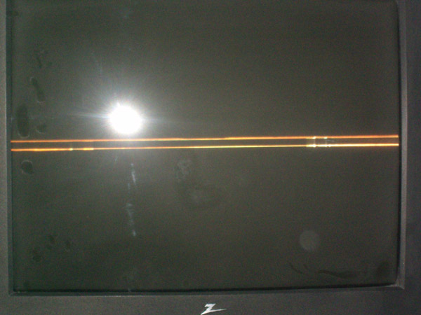

New member Username: DomotronixLas Vegas, NV USA Post Number: 1 Registered: Jun-08 | Hello all. A Zenith TV of mine suddenly lost its picture, or at least compressed it down to an inch or so line across the screen. Can anyone please tell me what this could possibly be? Its a Zenith C27C41T. Thanks in advance! ![]() |
Gold Member Username: John_sColumbus, Ohio US Post Number: 2301 Registered: Feb-04 | http://www.intechlabs.net/ourfaqs/tv/vertcollapse.htm |
New member Username: DomotronixLas Vegas, NV USA Post Number: 2 Registered: Jun-08 | Any pointers on what to look for? I was thinking blown caps or solder joints that worked themselves apart. Is there an IC that could have also went bad? |
Gold Member Username: John_sColumbus, Ohio US Post Number: 2302 Registered: Feb-04 | Sorry Dennis, can't help you. There's no real TV techs on this site; they're too busy fixing TVs. |
New member Username: DomotronixLas Vegas, NV USA Post Number: 3 Registered: Jun-08 | I figured it out. It was C2110, a 1000uF 25v cap that blew its top. Thanks! |
