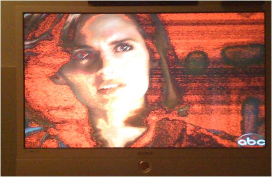

A friend has the samsung HLN5065W projection TV and he is having issues with the color. I am attaching two pics so you can see. I like to tinker so he asked me to take a look. I have never worked on something like this. Although i have worked on several LCD computer monitors. Any help you guys can give would be great. Even if its "Hey the cost is too much to fix" just let me know.

A wild stab in the dark but many of the DLP TV problems are caused by the color wheel:
Color Wheel #BP96-00250A Price $83.25 Call Encompass Parts
1-800-638-3328

That doesn't look like the color wheel problem, it's more like a DMD or digital video board. When the color wheel is defective you hear any whining or whirling sounds coming from the back of your tv, or there are colored blobs on the screen.
Try to bring up the tv menu with your remote, if the menu appears perfectly with no defects, then it's the digital video board. If not then it's the DMD board. Good luck.
