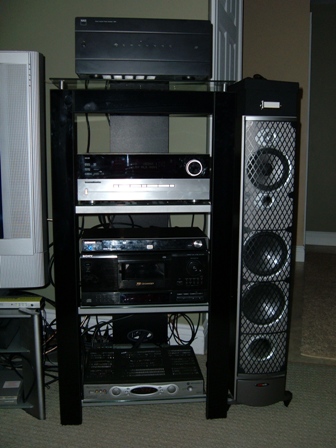

Can hardly see it - I will try to post a pic...

Username: Praetorian
Post Number: 473
Registered: Dec-05
As you can see by the morass of wires behind it, it is the least obtrusive in the set up...
