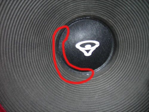

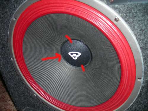

New member Username: XristosPost Number: 1 Registered: Mar-08 | Ok, I don't know too much about speakers, subs, or anything. All I know that since I've been a kid, these speakers have been my dad's pride and joy. Every time we have a party he busts these puppies out and rattles our house. The other day I decided to have a party while my dad was away. In a slightly "influence" state, I was showing off the subs to a friend and I put my hand on the sub while it was thumpin'. To my horror, the sub all the sudden started making a very raspy sound. The next day I took a flash light and examined the sub. My friend said that I probably cracked it. Upon further investigation I found out that the center of the sub with the Cerwin Vega! emblem was messed up a little bit. I tried outlining the area in Photoshop. There's no cracks, but it's almost like the lining where the middle emblem material connects to the ribbed part of the sub flexes. It barely moves and the sister sub we have doesn't do that, so I'm assuming that's what the problem is. Pretty much my problem is this: as I've said, these are like my dad's pride and joy. I don't have a steady job right now, but I might be getting one in the future. Is there anyway to fix this sub without doing more damage? The picture literally shows everything, I took a bunch but there's nothing like noticeable about what the problem is. You'd have to hear it. Any help would be greatly appreciated!! Thanks in advanced |

Gold Member Username: NuckPost Number: 9898 Registered: Dec-04 | Nick, these speakers are incredibly robust. The damage indicated to the dust cap is unimportant. However, the phase plug behind the cap is important, this may have been disrupted, although I doubt it. I once punched a 15" CV woofer and did no harm. Similar state, a long time ago. Should be no harm. And quit screwing around with somebody else's stuff, it might not be forgiving Dad next time! Be cool. |

Platinum Member Username: Jan_b_vigneDallas, TX Post Number: 12367 Registered: May-04 | . These aren't "subwoofers" and there's no "phase plug" in this driver. To be honest I don't exactly see what you are describing when I look at the pictures. From what you describe you probably bent the edge of the voice coil. There's no way for you to repair this yourself. Just tell your Dad what you did and offer to pay off the cost of the repair. Anything you attempt at this point will only make things worse. . |

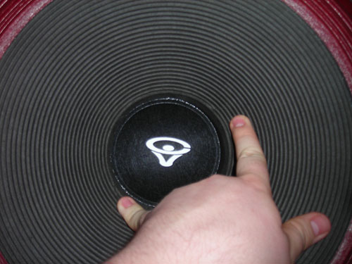

Platinum Member Username: WingmanaliveA pic is worth 1000 posts!! Post Number: 15149 Registered: Jun-06 | Does the sub make the scratching sound when you press down on the woofer (lightly) or only when it's playing? If it's only the dust cap that worked its' way loose and vibrating during use it's an easy fix with adhesive. If the voice coil is damaged that's a more dire situation. |
New member Username: XristosPost Number: 4 Registered: Mar-08 | The sub makes the noise whenever there's loud music. Someone said that they couldn't see a sub or something. The sub is the big one with the red ring. The regular speaker is on top. I'm sure you just mistyped or something because I think anyone could identify the difference. The thing is, we only use the speakers for parties. So pretty much three times a year the setups get used by my dad. The problem is, my open house graduation party is coming up on May 24th and I'm going to need the speakers for that. The speakers sit on either side of our entertainment center but because I have two younger step brothers in the house, my dad turns the speakers in towards the entertainment center so that the little kids don't kick them in. I called some places and described the problem. Two of them told me it needed to be reconed, but it could be other problems. I'm 99.99% positive that I could take the sub out one day after school, run up to this place and get it fixed. I'm sure the sub could be missing for days and my dad wouldn't recognize that they're missing. So it doesn't just have to be ME fixing. I was just saying that because I didn't know if there was some quick fix. One of my friends suggested super glue, but I decided against it. Anyways, could anyone like even possibly give me a guess-ti-mate on how much it'd cost to have this mofo reconed? My parents are divorced and my mom lives in Georgia, so I'm sure she could send me some cash to get this thing fixed. Oh, and to answer the question about the lashing. It'd definetly be the latter. My dad's former military and had a pretty rough childhood living in East Detroit (aka East Pointe for people that're noobs) so he can be really harsh sometimes. Not abusive, just really harsh. Thanks everyone for all this help, you've relieved a lot of my anxiety! Not knowing about anything is so much worse than knowing the bad points. And if I can possibly get this fixed without my dad knowing, well s**t, that'd be awesome. Thanks again, and thanks in advanced for anymore info!!! .nICK.f. |

New member Username: CaptingonadsTraverse City, MI United States Post Number: 2 Registered: Mar-08 | The dust cap may have come loose if there's no scratching when you push in on the sub when there's no current running through it. If you heard scratching in the sub at any volume the voice coil might be bent. You said LOUD music is what makes it sound distorted, you said you touched the sub when it was playing maybe somehow you knocked the dust cap loose and that's why you only hear distortion when the speaker(useing that in a general sense, they're all speakers) is really thumpin. Just a guess. |

New member Username: CaptingonadsTraverse City, MI United States Post Number: 6 Registered: Mar-08 | my friend, after reading everything here, suggested playing music on it and when it starts to distort then hold the dust cap, if the distortion stops, some super glue on the cap will fix it |
Platinum Member Username: Jan_b_vigneDallas, TX Post Number: 12375 Registered: May-04 | . Isn't sticking your fingers into the woofer how this all got started? Have you asked the repair shop whether the reconed speaker will look like the old driver? Most often they don't. . |
