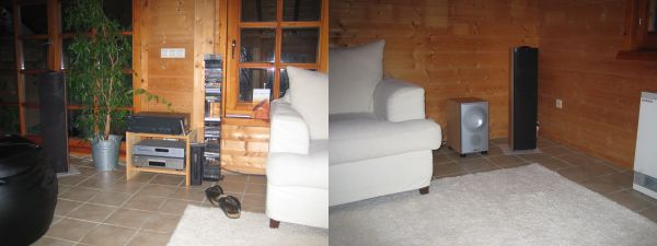

Hi all!
I wanted to ask about the setting of both the frequency and phase of the subwoofer.
Right now the frequency is at 85 "somethinh with" Hz and the phase is at 180°.
My speakers have the following specs:
KeF iQ 7
iQ7
Three-Way
Power Handling: 150 Watts
Efficiency: 90 dB
Frequency Response: 40 Hz - 40 kHz
Nominal Impedance: 8 Ohms
Dimensions: 8.7" H x 34" W x 12.9"
As you can see, the sub is in a 180° line with the speakers.
Should I increase the numbers above 85 or decrease...
What happens when I increase the frequency?
To my ears, its getting louder and more unclear...
When I decrease, its getting less loud and finally only a hint is there.
I feel that around 85-90 is good...
Then I regulate with the volume knob.
Which frequency would best fit to my speakers?
Any advice???
Thank u
Thorsten

I guess that's the sub in the center of the room. I would move it to one side or the other since center placement is typically not the best overall solution. Put "subwoofer placement" or "subwoofer set up" in a search engine and read a few articles and move things around.
If the subwoofer is being controlled by a reciever with a LFE output, you should run the sub's crossover frequency at full boat as high as it goes which essentially removes it from the circuit. If the sub's crossover is your only filter, I would set the crossover frequency as low as possible and run the front speakers full range. Once you run the filter above 80Hz, the location of the sub becomes more obvious and more intrusive. Where the crossover settles is up to you, your speakers and your room.
As long as the sub is in the same line as the speakers, set the phase control on the sub to 0°. Reverse the phase setting to 180° and listen for any improvement. If none can be heard, leave the sub on 0°.

Dear Jan,
thank u for answering so nicely.
"If the sub's crossover is your only filter,..."
The Sub is plugged into the NAD C370 via pre-out 2.
So, the frequency as low as possible, right?
With the phase I will try and with the position of the sub too...
Thank & Cheers
Thorsten

Hi!
I changed the position of the sub towards the right corner...very big improvement!!!!
PUNCHY!!!!
Very strong and clear punch-bass...I had to turn the volume down pretty much. Corner effect?? Sure is.
The phase is on 0° and its running on 85.
Great improvement so far....
Thank u & cheers

Try swapping the location of the speaker and the sub.
Username: Luxendel
Gondelsheim, Baden-Württe... Germany
Post Number: 43
Will try...
Reason is?
Username: Jan_b_vigne
Dallas, TX
Post Number: 12174
Registered: May-04
You'll probably still do better with the subwoofer loading directly into the 45/45° angle of the corner and the speaker should sound better overall when it is out of the corner and away from the sidewall. Put "loudspeaker placement" in a search engine.
Username: Luxendel
Post Number: 44
Just did as adviced!!!
Again lots of improvement!!!
Thanks, Jan.
Cool.

The pics in this thread are really helping, TL.
Username: Nuck
Post Number: 9717
Registered: Dec-04
That is a very good looking room, to me.
But a very hard and reflective room to listen in.
Username: Luxendel
Post Number: 45
Hmmmmmmmmm, could u be more specific Nuck?
How you mean "hard and reflective"?
Because of the wood and the tiles?
Right now, the sound is INCREDIBLE.
Fat as hell, crystal clear...the bass is so frigging tight...cool.
I do not hear any bad "reflective" sounds.
Its not muddy at all.
Removing the custom-bridges from NAD from main-in to pre-out solved the little harshness in the treble-area.
The whole whouse is made from wood.
Its the only room I can use for listening.
I know...the room is a uneven square.
The HIFI-system is in the second half of the room.
The whole room is apprx. 11m x 5m...
To me, all is fine...
Better it can always get...

Username: Dmitchell
Ottawa, Ontario Canada
Post Number: 601
Nice place, TL.
Username: Luxendel
Post Number: 53
Thank u, David...
Its a decent wood-house with a concrete platform (cellar).
The room is not really the best "listening room", but for a newbie like me, its fat enough.
Username: Dmitchell
Post Number: 602
Love all the wood!
I can see how that ceramic floor would create a lot of slap and echo.

Username: Luxendel
Post Number: 54
Yo, the ceramic tiles....not SUCH a big problem...
I can hear no real disturbance...the carpet also helps a lot.
Its the only room I can use...but I am right VERY happy.
We own the house by the way....
