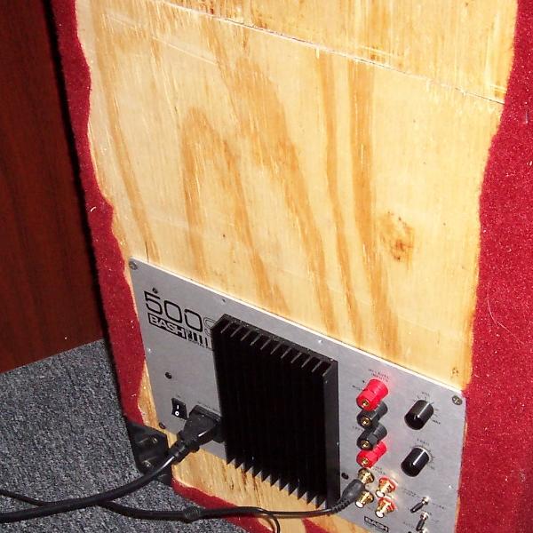

i am thinking about buying a 250 watt plate amplifier from partsexpress.com to power a 15 inch audiobahn car subwoofer. i have a very small room(8x8) with no carpet. would this audiobahn subwoofer be good for home audio use. im going to be using it with a home theater reciever but for music only. would a car subwoofer blow up a home subwoofer amplifier? plz help me with this question.
the audiobahns power handling is 650 rms, 1300 peak with a single 4ohm voice coil in a sealed box.
Username: Musicman70
Registered: Jan-05
this one is for tim0289cdfd, the sub your buying is fine for that room, you can run almost about any sub you can find, but i HIGHLY recoment buying a seperate reciever/amplifier just for the subs because in this case you wont blow your good reciever even thought i highly doubt it will blow it
P.S. buy the cheapest reciever for your subs, qualitly dosent matter its very low frequency anyways

found this page looking for home audio plate amps.. the main problem with hooking up car audio equipment in your house is the whole a/c d/c thing, and if your hooking it up directly to your reviever instead of an extrenal amp, your going to end up blowing your sub or screwing up your reciver. the standard car sub is 4ohms while the standard home audio sub is 8ohms. you also have to remember that your taking a sub that was designed to operate in a small enclosed space, where as a sub used in the home is meant for large rooms. however you can use a car sub in your home with the proper wiring methods and proper placement. you'll find that they'll be places you can sit in the room and hear NOTHING from the sub and in other places you hear it perfectly clearly. i've come to the conclusion that this has to do with the way that the sub and it's enclosure form the sound waves and how many surfaces they have to reverberate off of. when i had a bandpass box in my car i had to face the speakers toward the back seat to hear them good. when i switched woofers and had to use a ported box, i found that facing the woofer toward the trunk lid i was able hear it ALOT better than when it faced the back seat. this is the same in my room, i had to face the woofers the way i was facing and bounce it off the wall before i could hear anything at all, and then if i sit close to them their signal seems to decrease.

Username: Shawndecker1
Pine hill, Nj Usa
Post Number: 24
Registered: Apr-06
I just finished my home theater sub and used (4) 10" 250w car audio subs powered by a bash 500w plate amp. With a little elbow grease and some math, it works *@#! good! It pumps out the bass hard and I saved a ton of $$ making it myself. There are many scenes in Jurassic park that rattle the dishes upstairs! The biggest advantage in using car subs is the price difference. Amp and all, this 5' tall thumpin' sub only set me back about $350. Upload
