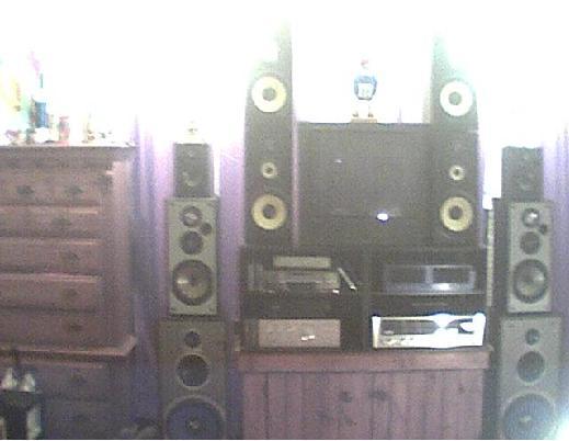

Ok, here goes, I got my V-12F's. I'm running them from a Kenwood KR-6600 at the moment, 60WPC. Sounds great. I'm upgrading to a Behringer EP-1500 Power Amp as soon as I can, however, until now, that's how I'm running them.
I realize when I run the Behringer amp, my SPL's will jump dramatically as I'll be more than doubling the power they get in RMS ratings. But I'm wondering about my EQ settings. Can someone tell me if those are pretty suffice for these speakers? They are ported to 28Hz.
16 32 64 125 250 1000 2000 4000 6000 8000 16000 32000 - All in Hz, from left to right.
Those are the set frequencies I can adjust.
+12dB +8dB +4dB 0dB 0dB +2dB +2dB +2dB 0dB 0dB +2dB 0dB
Those are my current adjustments from left to right in coordination with the frequencies listed previously, again from left to right.
If someone could suggest something, it would be much appreciated.
I run the CV's alone before you ask. The yellow Sony's alone, and the Pioneers with Sony sattelites on top alone, so three different setups.
Obviously I'd need three separate EQ's but the CV's are what I use mainly now.

What a set up. Why all the different speakers?
To begin with, doubling the RMS power will not "dramatically" jump the amount of SPL's you will hear. Though the quality of the new amp will make a substantial difference in sound quality, doubling the amount of wattage will only gain you about +3dB. So set you expectations down a bit if volume is what you are after.
Why in the world do you have the 16Hz slider set to +12dB? What do you play that has information down at the very deepest frequencies? Most music is not going to have much below about 50Hz, so you are wasting amplifier power and introducing distortion and noise by asking the amplifier to boost the circuit crud that exists below 30Hz.
I can only assume you are trying to get as much bass quantity as possible and there is no other reason for the way you have set the EQ. If that's the case, I don't know what you expect us to do. You are the only person who can decide what amount of bass boost is sufficient when bass boost is all you are after. If you were trying to smooth out room problems, then I could possibly have an answer for you. As is, there isn't much to tell you other than boosting frequencies with an EQ adds distortion and noise and will ultimately overdrive your amplifier. Try taking the center area down and leaving the bass flat. You have a tremendous amount of comb filtering going on with that set up and there really is no one right answer to what you want.
If I have misunderstood your desires for the EQ settings, let me know and I'll try to help. But, this would appear to be nothing more than boosting the bass for the sake of boosting the bass and how the rest of the system sounds is irrelevant.
How did you arrive at these settings in the first place?

Well basically, I'm only listening to the CV's alone. So I have the EQ set to adhere to THEIR needs, and theirs alone.
What I'm wanting to know is do I have the EQ set right in coordination to the port tuning on these speakers. I'm not sheerly after volume (I know doubling gives +3dB and that a ported system already has a +6dB gain over sealed) but the cleaner power with more headroom will still sound much better I'm hoping.
I have the bass/treble knobs on my Kenwood set to +2 for bass and 0 for treble.
What I need to know is basically what would be proper settings for the EQ for the CV speakers. I listen to a lot of music that drops down to 25-30Hz, but nothing any lower than that, other than some bass tests. Any help would be appreciated.

Then the first thing I'd do is get the other speakers out of the room, that will help the CV's if anything will. I have no concept of what you mean by adjusting the EQ to the needs of the speaker. The designer did that when they built the speaker. You do not adjust an EQ to the port tuning of a speaker. Once you reach the resonant frequency of the speaker system the bass rolls of at 24dB per octave in a bass reflex design. Trying to boost the bass when it is falling at this rate is simply not going to achieve anything other than distortion. While you might think the music you listen to has usable response benath 30Hz, it is really unlikely. Trying to boost what is not there is a futile endeavour.
You either adjust EQ to the needs of the recording, the needs of the room or just to make things sound like you want them to sound. I would say your situation definitely falls into the last category. So there is no right or wrong in that sense. What you are doing, however, is creating the wildest ride imaginable of ups and downs in the frequency response of your system. Your speaker location is horrible. It is adding a lump in the botom end response. The bass control on your receiver is affecting everything beneath 500 Hz or so with the boost you've added there. Each of the center frequencies on your EQ is just that, a center frequency and the transition from one center to the next includes a dip in between the two centers. This creates what is called a "comb filter". In short, there is no rhyme nor reason to what you have done other than you want more bass. The only help I could provide, other than the suggestion I made in my first post here, is to remove the EQ entirely and read about speaker set up. Otherwise, you are merely pushing sliders until you get what you are happy with.
