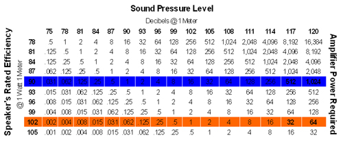

Silver Member Username: PetergalbraithRimouski, Quebec Canada Post Number: 714 Registered: Feb-04 | Gvenk, I was looking on th net for a table commonly seen listing power requirements for various loudspeaker efficiency, but couldn't find one. If you have seen them before, you'll know they go way lower than 1W. But I stumbled on this page: http://www.jwd.com/tech/notes/tn70.htm It says that 0.5% efficient speaker (low efficiency) require 0.08 watt per speaker for background music. |

Bronze Member Username: VgtvidzPost Number: 59 Registered: Jul-04 | Peter, is this what you were looking for? ![]() |

Silver Member Username: PetergalbraithRimouski, Quebec Canada Post Number: 716 Registered: Feb-04 | VGT Vidz, Yes, that's a good example. Although I'd prefer one to give SPL in a typical room rather than 1 m away. My speakers are rated at 104 dB. Given that I listen at peaks of 90 dB most of the time, that table suggests I need way less than 1W. Gvenk, you have shown disbelief that this is even possible. You also choose to ignore my main point that there is nothing magical about 100W other than pure marketing. If 50W is much less expensive to build, well it's only 3 dB down from 100W so why not go for that instead? What do you reply to that? TB, I never said the h/k was rated at 100W x 7 so I don't why you want me to prove that. It's rated at 50W x 7. It was tested by a magazine driving 5 loads at the same time. I don't know why they didn't test 7, nor do I care. I'm currently using it for 5.1. I can provide a link to the PDF if you want. The carver M4.0t is not the cube. It's in the same family as the M1.0t. I may be wrong about the specs because I don't have the manual. I see 2x375W into 8 ohms on some other web page so I'm not sure any more. |
