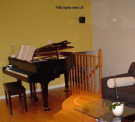

Username: Myrantz
Post Number: 1561
Registered: Aug-04
Larry
And Mer. Well, that's a shame about the 'Orbs' but frankly, I didn't think they would make the grade - I know they wouldn't for me at least - there's just so much that won't fit into a tiny unit, let alone come out of it.
Here's something to ponder - have a look in the second photo posted back up in this thread (Sunday, March 13, 2005 - 06:47 pm), there's a couple of nice looking B&W's on stands against the rear wall. I believe these may be for sale?
Just a thought - I don't want to start anything. [grin]

Larry,
I saw my name in your surround-speaker angst post, so here's a reply:
I do have the PSB Alpha Intro LR as surrounds in our family room. Here's the picture:
(Do you still have the link to my website? If so, click on the "Home Renovation Project" link and you will see the Alpha pair in the first two Family Room sequences).
Here's the official PSB link: http://www.psbspeakers.com/s/newAlphaSeries.html#alphaIntro
I bought them last year and so far, I'm pleased with the (a) detail; and (b) good bass and clean mid-range for a speaker this size.
It comes in black; I'm not sure how Mer will think of it. But I dare venture to say that they sound better than the Radio Shack twins that you have.
