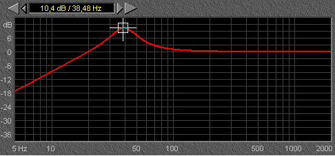

Gold Member Username: Joe1234Post Number: 1123 Registered: May-09 | Ok so here are one aero ported enclosure design and one slot ported both feature dual layer baffle face (for flush mounting) and both are 1.73@36Hz: First off the 4" aero does not pass the Va/Vb rule: 12.56/1.73 = 7.263 and should be at least 9 but anyways: I would recommend a ~5" minimum aero port diameter. And here is the familiar slot ported option: Enclosure Specifications: Fb = 36 Hz Vb = 1,73 ft^3 External Height = 15 in External Width = 19,13 in External Depth = 20 in Port Width = 2 in Cut List: * All Dimensions in Inches. * Wood Thickness is 3/4 for all Parts. External Enclosure Parts: Front = 16 3/8 x 13 1/2 Front Internal = 15 5/8 x 13 1/2 Back = 19 1/8 x 13 1/2 Left & Right Sides: Side 1 = 18 1/2 x 13 1/2 Side 2 = 17 3/4 x 13 1/2 Top & Bottom = 19 1/8 x 20 L Port Internal Assembly Parts: Front to Back = 16 1/2 x 13 1/2 Extension = 7 1/8 x 13 1/2 Almost the Skar recommendation and it stinks with a 10.4dB peak at 38.4 Hz but at least be loud.. I don't recommend either but in the name of testing I guess it's ok. |
