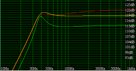

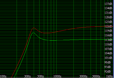

Silver Member Username: Joe1234Post Number: 962 Registered: May-09 | Ok Chuck this is a comparison between the Fi BTL N2 (red 2K) and the HDC3 (green 1k) one can see that one way or the other the Fi wins. But since it's falling below baseline at that port tuning then that means it's made to work at higher frequency, not the HDC3, it peaks well above baseline. If you are going for daily to SPL the HDC3s are right on. The DCXL would be about the same but with higher power hadling (1500W) in fact is specfied for 1.5 cubes ported. |

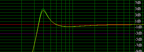

Silver Member Username: Joe1234Post Number: 967 Registered: May-09 | Ok Chuck it's all about exploring, take a look at these comparison all subs are 1.5cuft@38Hz : Green HDC3 12" @1000W RMS Red DC Audio XL @1500W RMS Yellow SSA XCON 12" @1750W RMS If power is no object I would go with the SSA XCON it can work a bit lower and it has SQ qualities others won't match. The HDC3 is very efficient at resonance almost reaching the others on higher power, The XL is more SPLish and would work better tuned higher, another candidate could be the Fi BL (1500W RMS) I will take a look at it next. The HDC3 can be overdriven to 1800W each no problem but I wouldn't bet on much more. But as I told you before power handling is on the enclosure design as well. And good news that you've got game with the TEK! |
