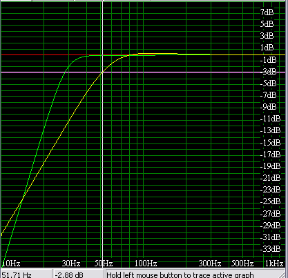

Ok, just to give you an idea of where you are, take a look:
Your sealed 1.8 cuft is performing like in the yellow curve with a laughable F3 = 50Hz so no real bass there.
A big ported enclosure would perform like the green curve and would be as loud as a sealed enclosure on 1500W RMS power. Specifically 5.58ft3@28.5Hz will give you deep bass of F3 = 27.6Hz. for two db124s.
Your amp fits those speakers perfectly on power.
Play with the software, I think you can shrink that box to 4 cubes without loosing much bottom end. Read the other thread or the software help if you have questions, I think it's all there.

Wow. I had no idea it was that bad. By just listening to it, I would've predicted F3 to be around 40Hz at the worst. I didn't think it would make THAT much of a difference going with a ported enclosure, so I am really excited to hear what it'll sound like. I'll have a bit of a play with winisd (well try to at least, haha) and see how much I can shrink that enclosure, because that volume is probably internal, and before sub and port displacement, am I right?
