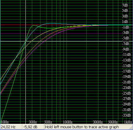

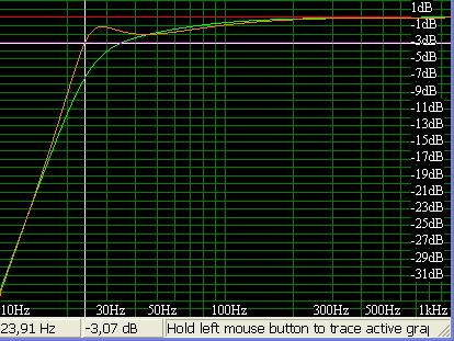

Silver Member Username: Joe1234Post Number: 383 Registered: May-09 | There you see the response for the 10" TCs: 1) green single sub in a 1 cuft ported tuned to 25Hz 2) yellow dual subs in isobaric compound: in a 1 cuft ported tuned to 25Hz For 1 as you can see you get F3 about 35Hz. For 2 where the cross hair is at you get F3 about 24Hz of course the catch is that 4 drivers are needed, in a face to face isobaric the same box is used as in a single driver. Isobaric is not efficient nor cost effective but will get you those deep lows if you are determined to get them. |
Gold Member Username: JbpittPittsburgh, Pa. Usa Post Number: 1281 Registered: Jul-09 | You wont be disappointed with the epics.... |

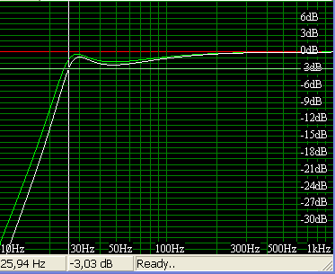

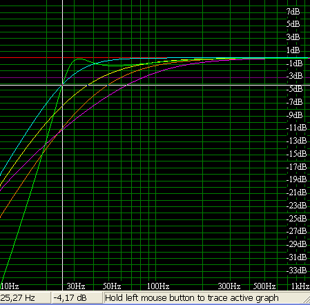

Silver Member Username: Joe1234Post Number: 411 Registered: May-09 | On blue, the Eclipse SW8000 On yellow the Eclipse SW8010 On orange the TC Sounds Epic 10" On violet the Soundsplinter RLi10 On green TC Sounds Epic 10" ported 1.7cuft@27Hz Vent: 3.23"x13.89" that is 0,26 cuft airspace. Total airspace per sub = 1.96 cuft The ported TC will substantially outperform any sealed configuration in deep bass for any frequency above 25Hz also only 2 will be needed due to ported efficiency, same airspace needed, and lower cost. The SW8000 is unbeatable for sealed. |
Silver Member Username: Lord_huggingtonOntario Canada Post Number: 449 Registered: Oct-10 | That's 4 SW8000's in 4 cubes sealed and 2 TC EPic 10's in ~4 cubes ported... ? I have to figure out how to use winisd! After 42 Hz the Eclipse's are only 1dB louder, but they have such a nice curve, exactly how it sounded in my car compared to the XXX (like the green plot). 25-42 Hz is only -2 dB from the Epics, which start dropping off only 2 Hz away from the Eclipse's, making my statements... true! MUAH! That's why I roll with LMS... or used to *sigh*. So after cabin gain you'd have somewhat peaky Epics or flatter SW's. Can you please do a plot for the SW8000-SW8200-SW8010-SW8210 in 1 cube sealed for all? I'd like to see which is the most gut-busting. |
Silver Member Username: Nevertoomuchbass2 Fi Q 12s, Mmats 3000.1 Post Number: 304 Registered: Aug-10 | wow haha F3 at 23hz must be amazing. I'm not familiar with 4th orders at alllll though. dont know anything about them other than its a type of bandpass box. would 2 epics ported really be louder than 4 SW8000's from 25-40hz? |
Silver Member Username: Nevertoomuchbass2 Fi Q 12s, Mmats 3000.1 Post Number: 305 Registered: Aug-10 | yeah im definitely diggin that nice flat curve for the sw8000. good thing i didnt just go ahead with 4 rli10's. i second Lord Huggington's request for a graph for the eclipses |
Silver Member Username: Joe1234Post Number: 412 Registered: May-09 | First off my apologies the SW8000 an the TC sealed curves were at optimized volumes (much higher on the SW8000), here are the correct responses: Sharing airspace will not affect response if proportions are kept so if you put a second driver and double the airspace the response will be the same (+3dB of course), with ported you only add a second port of same dimensions. All sealed are at 1 cuft. Not everyone like the idea of sharing airspace but in this case I would do to control the box size. In the corrected curves the SW8000 shows the effects of airspace starvation loosing some extension and giving the ported TC 1 hertz advantage, also to note is that the SW8000 will play louder higher frequency content so from that standpoint the ported will perform better. I would gladly compare the eclipses but placing the 12"s on 1 cuft probably will not be a good idea so.... |
Silver Member Username: Joe1234Post Number: 417 Registered: May-09 | I wanted to add that real world cabin gain is pretty chaotic full of resonances and really dependent on the car and when you see a 0.5 to 1 dB boost/cut somewhere that's not going to make a meaningful difference. It's modeled as a -12dB per octave gain starting somewhere in the 50-90 Hz region but usually is measured for a car, some modeling softwares let you import gain data into your model. I am looking to upgrade from winisd. And if you happen to have parametric equalization there are a lot of issues that can be cured as far as response goes. |
Silver Member Username: Lord_huggingtonOntario Canada Post Number: 450 Registered: Oct-10 | How about 4 of the Eclipse's in optimized sealed volumes? How do you find the optimal space? |
Silver Member Username: Joe1234Post Number: 422 Registered: May-09 | I have seen the equations to optimize for linear response, obviously this software is using those. The SW8000 optimizes at 1.765 cuft The SW8010 optimizes at 0.346 cuft (It actually gives better performance than on a 1 cuft! ) Still the ported TCs give significantly better deep bass, the soundsplinters also fit at incredibly tight airspace but the real deal is the SW8000 for sealed. Anyways 4 cubic feet internal is already above the limit Will have, I tried because he says he has13 extra inches external width but above 4 cuft internal I don't think he has. Will you should check again the max volume you can fit to really come up with solid options. |

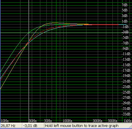

Silver Member Username: Joe1234Post Number: 438 Registered: May-09 | Yes the Autoteks perform...Will they melt under the sun??...lol. Will you would get around 2 dB more with 3, But I like 2 12"s for what you are trying to do, those are $5 more each will give you the 2db and in a 2 ohm load. Its just a question of how to place them right. |
Silver Member Username: Nevertoomuchbass2 Fi Q 12s, Mmats 3000.1 Post Number: 315 Registered: Aug-10 | yeahh if i really got intricate with the box design i could definitely put 2 12's in there. but if i was gonna do that, how much better would the epics really hit the lows compared to my Q's? |
Silver Member Username: Joe1234Post Number: 444 Registered: May-09 | Both ported designs fitting 5.17 cuft On white 2xFi Q 12" On green 2xTC Sounds 10" They perform almost the same but since you can put 3000 to the Fi Qs you get +5dB over the TCs......and that is what I am talking about!! seismic activity!! Definitely try to design around your 12"s you will get exactly what you want, you just were running them in wrong box. |
Silver Member Username: Nevertoomuchbass2 Fi Q 12s, Mmats 3000.1 Post Number: 316 Registered: Aug-10 | haha wow after all this and im right back wherte i started :p i really appreciate all yall's help though. no other forum is this insightful. i asked the same question on the SMD forum and ca.com, and got nothing. so at the end of the day, are my 2 Q's the best option out of all the eclipse, soundsplinter, and tc sounds 10's/12's? |
Silver Member Username: Joe1234Post Number: 449 Registered: May-09 | What makes best the Fi Qs is that they can be wired at one ohm and that have much higher RMS rating. The TCs response is fantastic for a 10" though I have not modeled a 12" but since your amp is not 0.5 ohm stable like the .05d the Fi Qs are best for you. You just have to install them in a way that you don't have the subs in your face if that's the problem, maybe an slightly angled top. Also I have not explored the 10" Fi Qs who knows, you have to think about all this before doing anything. Its amazing to see what this top subs can do though, |

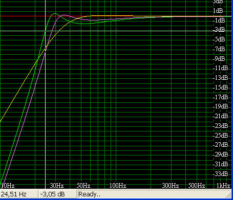

Silver Member Username: Joe1234Post Number: 464 Registered: May-09 | Ok Will so for 12.8 in instead of 12 figures are as follows: External Dimensions; L = 43 in H = 22 in D = 12.8 in Gross internal volume = 5.56335359 cuft Vol port = 0.98756778e-1 cuft Vol driver front mounted = 0.1178101 cuft Total Displacement = 0.43313376 cuft Vb = 5.13021983 cuft Drivers 2x Fi Q 12" DVC 2 ohm Enclosure spec: 5.13@28Hz F3=25.37Hz 2x Vent L = 13.58 in Dia = 4 in Yes ports should be kept 2-3 diameters from each other. It would be wise to send this to Bassman3 for review. |

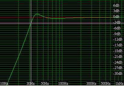

Silver Member Username: Joe1234Post Number: 476 Registered: May-09 | Will I have finally upgraded from WinISD to better software and reviewed models for vent size and all disagree with WinISD on minimum port area so I strongly recommend to check with bassman3, maybe I will post back something working with the 22x43x12.8. |
Silver Member Username: Joe1234Post Number: 488 Registered: May-09 | Ok Will this design will deliver F3 = 27.5Hz as measured in the curve and has no port noise issues. It's expected to produce 131dB@31Hz after cabin gain. External Dimensions; L = 43 in H = 22 in D = 12.8 in It uses 3 ports D = 4" x L = 17" These ports should be put like this: PORT - SUB - PORT - SUB - PORT Port airspeed is 4% of Mach at full power so no port noise. The problem with WinISD allows up to 16% of Mach while many agree that it should never be above 5% Box Properties Type: Vented Box Shape: Prism, square Vb = 4,928 cu.ft Fb = 31,94 Hz F3 = 27,50 Hz (baseline is gain at 50-70Hz) Fill = none No. of Vents = 3 Vent shape = round Vent ends = two flared Dv = 4, in Lv = 17, in Square Prism Box Parts 1 Top, 1 Bottom: 12,8 x 43 in 0,75 (thick) in 1 Front, 1 Back: 20,5 x 41,5 in 0,75 (thick) in 2 Sides: 20,5 x 12,8 0,75 (thick) in Vent Parts 3 Ducts: 4,25, 4 x 17 in Dacron damping can help reduce group delay among other things you may use it but it will cost you a little bottom end. Also subsonic filtering below 20Hz is recommended. |
Silver Member Username: Nevertoomuchbass2 Fi Q 12s, Mmats 3000.1 Post Number: 324 Registered: Aug-10 | wow thats amazing. haha you are a master at this stuff! i'll have to tweak the width of the box somewhat, but would it make any difference as long as I keep the same volume? |
Silver Member Username: Joe1234Post Number: 490 Registered: May-09 | Yes if internal volume is preserved no major changes should occur unless the internal flange of the port nears too much the bottom of the box. Anyways since the model is already entered on the software, if you give me the new dimensions I can recalculate very easily. Some airspace is also needed above the external flange of the ports or the box will detune. |

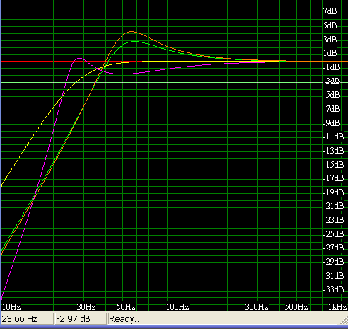

Gold Member Username: Joe1234Post Number: 1032 Registered: May-09 | Hi will, I was just wondering what did you end up doing and how did it went. |
Silver Member Username: Nevertoomuchbass2 Fi Q 12s, Mmats 3000.1 Post Number: 327 Registered: Aug-10 | well basketball season started, and all projects came to a halt. i decided to just go with one of my Q 12's in a 2.5 ft^3 slot ported box tuned to about 32hz, as i didnt really feel like building a complicated box for both of them that would have to fit like a glove. i got all my wood cut and its been sitting on the side of my house for a good couple months now. even drilled through the firewall to run my 1/0 and threw my deka under the rear seat |
Gold Member Username: Joe1234Post Number: 1047 Registered: May-09 | Yes that design was like a nightmare to figure out and build...lol anyways hope you can comment on how it all came out when you put it together. You certainly have enough amp to melt that Q! so go easy on it |
Silver Member Username: Nevertoomuchbass2 Fi Q 12s, Mmats 3000.1 Post Number: 328 Registered: Aug-10 | haha well my Q's are fully loaded, and i beat on em all day with the mmats at 1 ohm, so i think 1 of the Q's at 2 ohms should be okay |
Gold Member Username: Joe1234Post Number: 1049 Registered: May-09 | Ohh right you said those were double 1 ohm not double 2 so wired in series it's safe.. |
