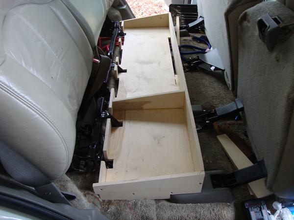

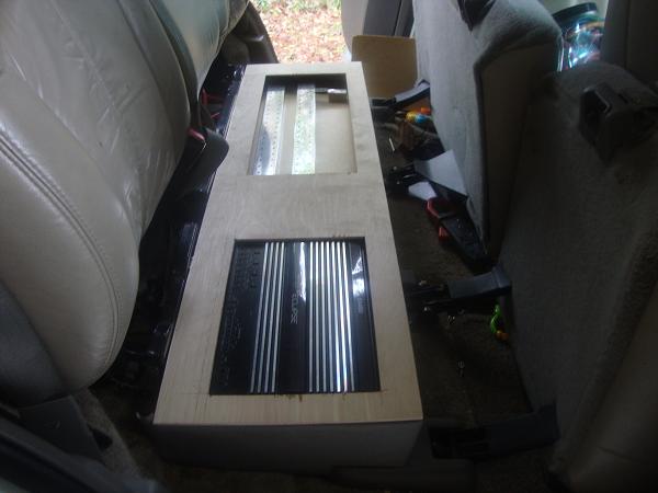

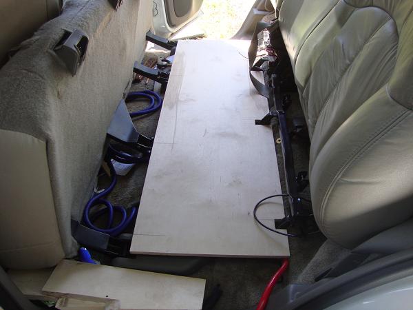

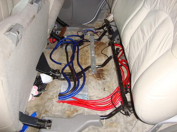

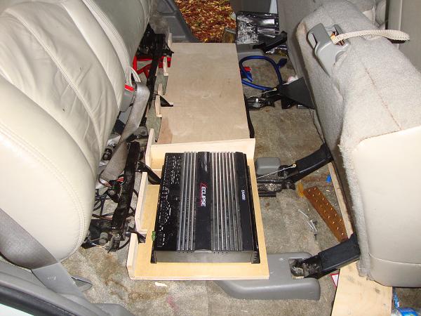

  Gold Member Username: TejcurrentPost Number: 2745 Registered: Apr-07  | I have the one SD 16k, but without the busbars I can't hook it up properly. This made me spend a bit of time starting a new rack to hold things a little better than the last.  The old rack - figuring how I want things   beginning with some card board, placing end caps       I'm using 3/4, 1/2, and 1/4" baltic birch for different portions     Removing the wiring from the old busbars, rerouting a bit, and cleaning things up so I can fit 4 more runs in quickly. Then started the floor.       Making sides         Going to clean things up a lot before wrapping in vinyl         Flush with the top plate. I was going to make the top plate so there wouldn't be any gap around the amp, but decided to leave 1/8". I may be sorry but I can redo this part really easy.       I had to stop, but a few more cuts and it'll be done. Once it's wrapped in vinyl and a few other things it should look nice- looking at that last pic it looks a bit ugly lol, but it should look much better once it's done.  |

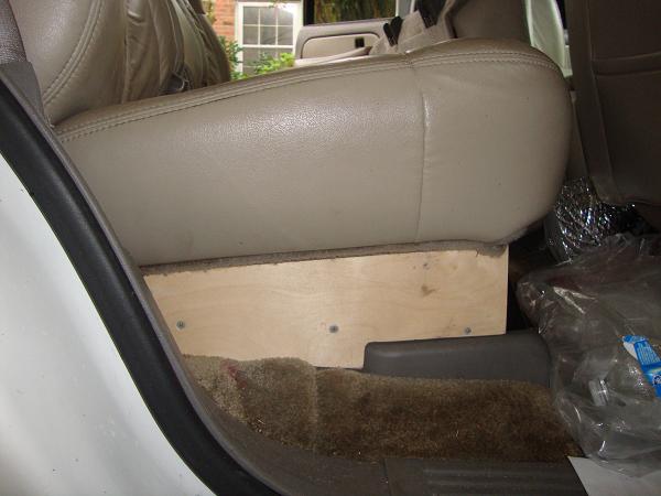

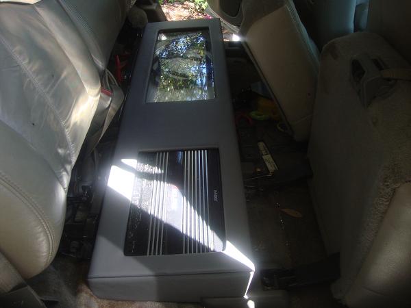

  Gold Member Username: TejcurrentPost Number: 2746 Registered: Apr-07  | Thanks.  deathoob come on by whenever, you thinking about coming to Myrtle beach? Twiztid, I like the amp. I've had it for 4-5 years now. I've meant to get the XA4000 several times, but this has served its purpose well (EA4000). I really don't need more power yet, and I'll probably just bridge it on 2 sets of components and add another for the rear components, with 2 extra channels for future upgrades. It was a nice upgrade over the kicker 350.4 I had before, looks great, never gets hot, has 8 g speaker inputs, and runs cool. Anyway back to the build. I can't believe no one mentioned how ugly that rack was looking. I looked at it this morning and ripped it out. I really wanted the extra room at the front for wiring, and to have good ventilation for the amp, but I wanted it to look cleaner so I'll fight with the wiring a bit. Looked like crap   I ripped it down to the bottom large board, removing the sides and 'divider' beside the amp. Made new sides that covered a bit more, and raised the overall height a 1/2" or so on the front side.       I plan on making the area under the busbars white, but I don't want people to see down next to the amp so I wanted to paint it black.     While the paint was drying I decided to remove my oooold ground busbar from years ago. It's was grounded to the frame in several places, then split off to several amps. It was convenient to have 3/8" bolts ready to go. Oh yeah, and my brother left a chain saw on the seats that leaked oil onto the carpet- going to be shampooing the whole thing or buying new carpet. It's looking nasty.   Wrapped and ready to go. I used the closest color I could get to the factory panels, I'll get a doors shot when I get a chance but it matches well.     This is what the busbars will sit on       That's all I got done. Next week I'll see if I can get a few hours to lay out the busbars, drill the holes (each 'fuse' block must be bolted- that's 27 + the 2 main bars) and white out this board. Then a top plate, vinyl that + plexi. Also 4 more runs of 1/0 I need to drill a hole in the firewall for.  |

  Silver Member Username: MystrePemberville, Ohio USA Post Number: 732 Registered: Sep-05  | Yea, looking good. Not bad on the color match. Most of the pics you can hardly tell. Besides, to me it looks factory. |

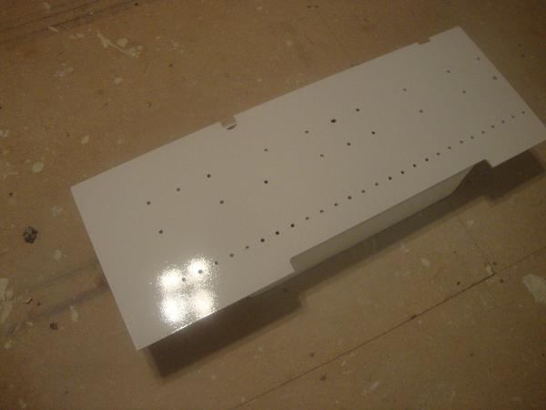

  Gold Member Username: TejcurrentPost Number: 2748 Registered: Apr-07  | Thanks, a small update:  I want to get those busbars in so I can get at least my door speakers working so that's my focus right now Another picture that shows the color match- it really looks different depending on the angle lighting to me. Some times it looks completely the same, other ways like 90%               My special deep hole marking pencil           And painted the panel white so it can dry a day or so, then attach the busbars.  |

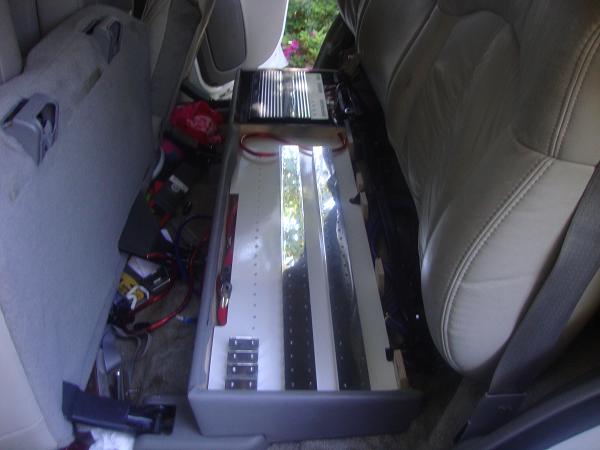

  Gold Member Username: TejcurrentPost Number: 2750 Registered: Apr-07  | Idk what happened, but most of the pics were corrupted so there's only a few left to post   Rovin, I'm positive on at least 12, but I may do more, adding some voltmeters to help me decide. 1/4" plexi, test fit before wrapping completely         This is a mockup, but figuring out a way to clean up the wiring under the hood- mainly the fuse holders.     ![]()  |

  Gold Member Username: TejcurrentPost Number: 2751 Registered: Apr-07  | Thanks guys, waay to much credit! I really appreciate it though, when I start thinking of how much money and time I really have in these bars and the rack in general it makes me cringe, but I love the result.   I have serious plans for driving up the East Coast this summer, at least up to Maryland for shows, so I want it to look a bit nicer. There are still things I want to improve on, but I'll wait until the next 'rebuild' or until I get things up and running and get the itch to do work lol. I still have this to sand/polish   I decided to install the 4 runs of wire I already have, and hook up my 4ch amp so I can have music until I get time to finish the small blocks and install the 16k.   ![]()  |
