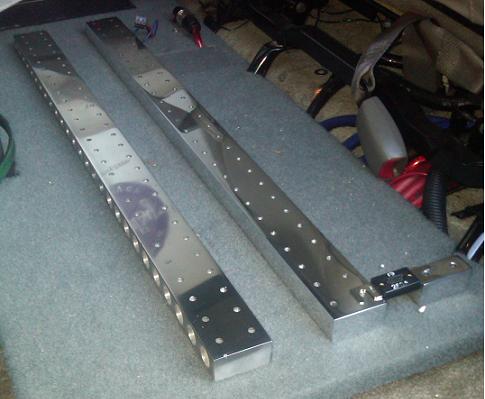

I'm rebuilding my Tahoe for 2011. It will be several months before it's finished due to time and cost restraints, but before Spring if all goes well. I'd like to get to start off March or so competing. I don't want to let out all the details before hand, but somewhere between 20-40kw no wall. Before installing the equipment I'm spending a ton of time/effort on the electrical system.

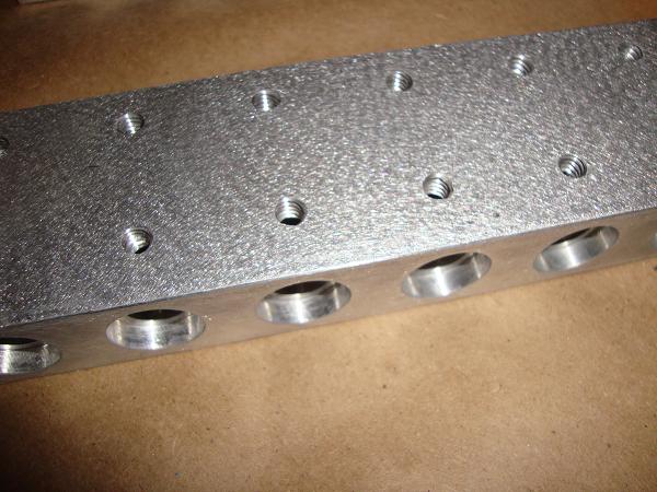

A month or so ago I decided I wanted to do a nicer looking setup, so I chose aluminum bus bars simply because I like the look of l.e.d. lit polished aluminum over copper. There's enough metal involved I don't think it will have much effect on things.

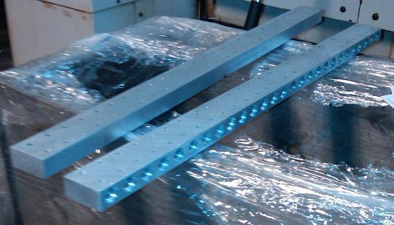

They are approximately 30 inches long, with 27 slots of 1/0 (though I think 2/0 would fit). 6 runs of 1/0 from the front for power, and 6 for ground, for a total of 12 runs of power wire. Basically one run of + an - per alternator as I'm shooting for 6 alternators. I'm almost finished with the bracket just need some one-off pulleys machined. There will be around 1500 amps peak with 1100 or so at idle.
I'm also shooting for at least 8 XS Power D3100s in back, with 2 S3400s up front. These will be connected by their own busbars, but I wanted to run 1 run of 1/0 per battery. Each wire is fused where it connects with 300a fuse. There's a total of around 250-300 ft of 1/0 being used to hook everything up. I'm not sure how much power I'm going to settle on, but I want to be prepared.

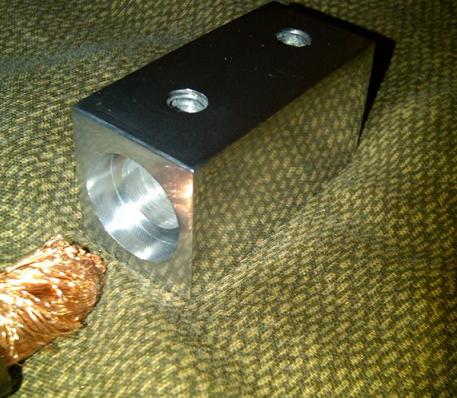

Playing around in Sketchup laying it out. One fused for power, one solid for ground:

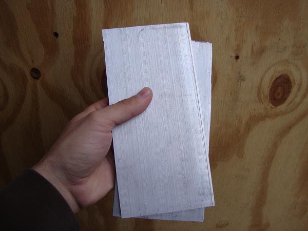

A raw aluminum piece before polishing.
Quick light polishing just to test some different compounds.
And the main bars:

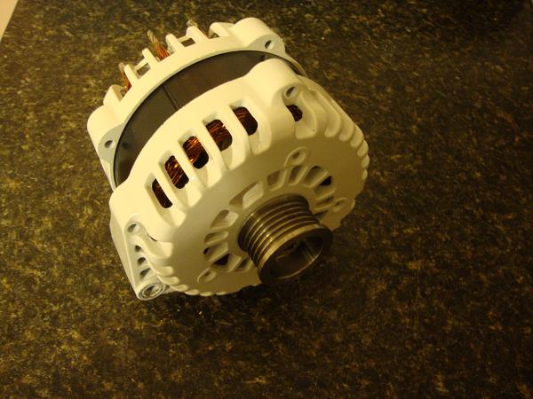

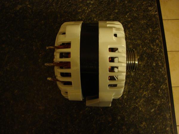

I'll continue to update this thread as I do more work. I'll be putting the quad alt bracket in as my new pulleys arrive for the alts, plus welding the battery rack, etc etc etc. The additional 2 alts are a +2 bracket that should be a nice bolt on for those with a quad kit

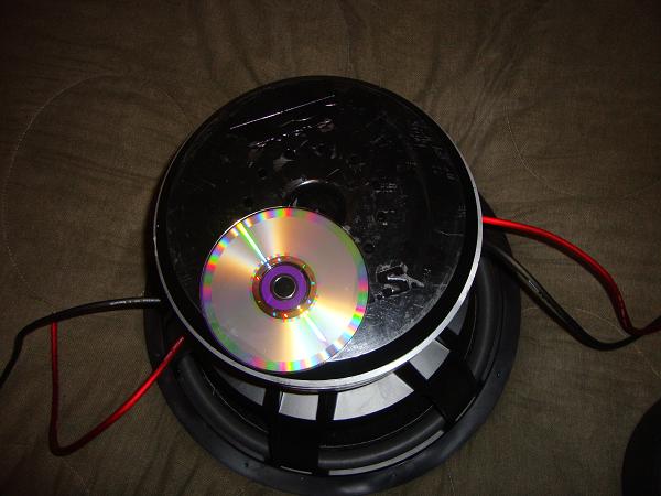

Any suggestions on an 18" sub that will handle 5kw for long periods of time? I already have it narrowed to 2 choices but it's nice to get opinions on something I haven't considered.

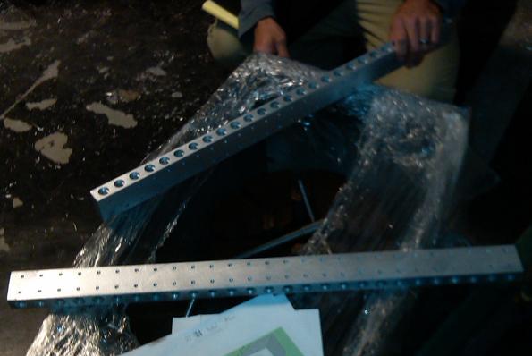

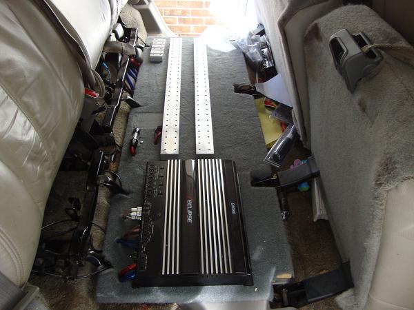

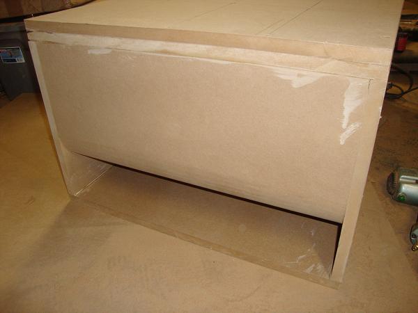

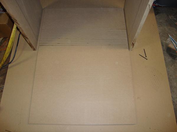

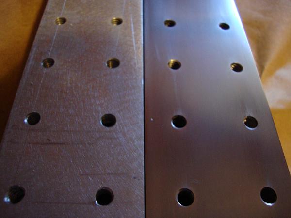

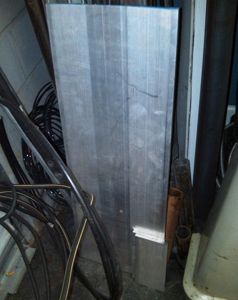

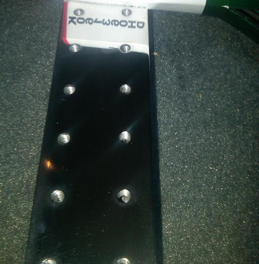

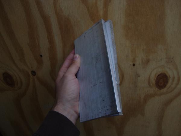

Started testing a bit more with polishing those bars. The aluminum stock had been banged up and then sanded, so it had deep pits and scratches that needed a good bit of sanding. I did 80, 120, 220, 350, 600, 1000, and 2000 grit, wetsanding with the last few. Then some polish, which I'll need a bit longer wetsanding- the scratches just aren't visible until the aluminum is buffed unfortunately.

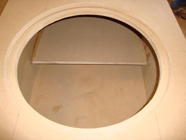

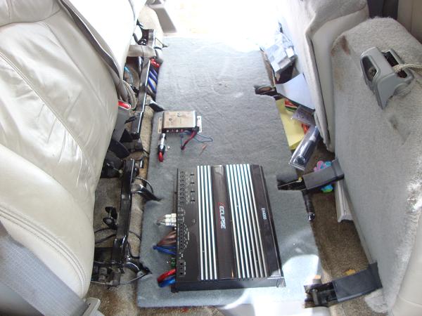

First off I'm redoing the rack under my seats. I carpeted it and made a cheap mdf plate like 3+ years ago. It looks like crap, so I'm making up something with birch and using vinyl + plexi.
Now
Laying out the dimensions for the bus bars.

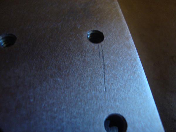

You can see the grain from sanding
And the deep scratches
After 220 grit
And 2000 grit
I still have a whole bag full of these things to sand/polish. Figure each one has 2x the sides that need polished as 1 big bar, so it's like sanding 5 big bars, I'm estimating about 1-2 hours per bar.
That aluminum dust stains like crazy, but after a bit of buffing it's very reflective. Still a ton more work to do on them, I just got about 2 hours in today, including stopping by the store to pick up buffing supplies.
They'll probably still have some grain in them when I'm done, but I'm pretty happy with the result so far.

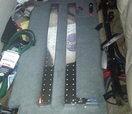

Username: Tejcurrent
Post Number: 2632
Registered: Apr-07
lol, weird picture.
I'm going to be using led's around these bars, so I figure the almost chrome look would 'show' best. I like the brushed look, but I'm going for a really clean appearance when it's all said and done and the polished bars just look a bit nicer to me.

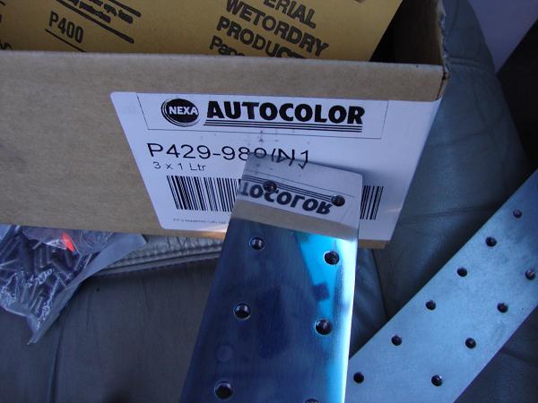

lol, sorry I'm slacking. My shoulder is sore from sanding, I spent a ton of time sanding/buffing the 2nd busbar. Anything over 220 grit I wetsand with soap/water and a sanding block.
I sanded the next bar with:
60
120
220
---hand sanded after this point---
320
400
600
1000
2000
I'm really happy with the result over the first bar, so I'll probably resand it starting at 400 grit tomorrow. The 2nd bar is like a mirror, other than a few swirl marks that are so fine no polish I have will remove them. It took me 20- 30 minutes to sand one of the 27 small blocks, so 26 x .5 = almost 13 hours of sanding and buffing left. I'm really happy with how mirror-like they're coming out though. The feeling and look of the polished bars is so much more refined and finished feeling over the coarse raw aluminum, definitely worth the effort imo.

I'm slowly getting everything together, I was considering what to do with these aluminum pieces for some grounding busbars to the frame or something, They are 3/8" thick x 4" x 9":

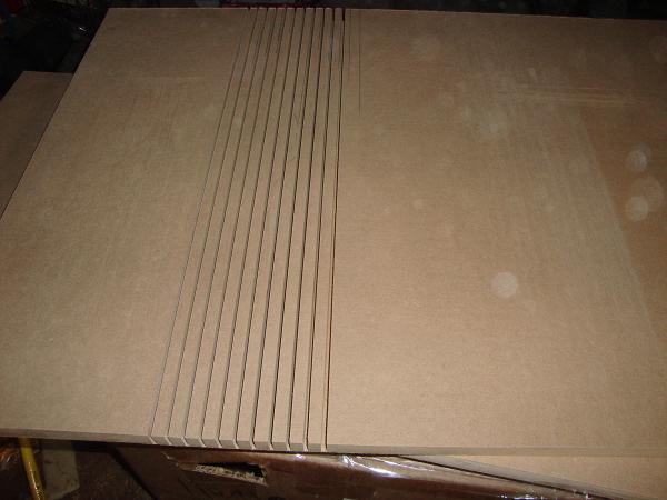

Then I sat them in the corner and started thinking about using the big sheet 3x8 x 12" x 3.5' I'm thinking about a busbar for the battery bank, a retarded overkill one maybe? I may split this in thirds, or just continue to use the 1"x2" bar I started with inside the truck.
Updates: I'm waiting on my first of several subs, and probably starting on the battery rack tomorrow. Last night I didn't get home from work till about 10:30 (started at 7am) so I just don't have a lot of time for this build right now. When the equipment comes in I will make a few days.
Depending on how the sub works out here's the equipment list:
2 T3 Audio 6.5 comp sets glassed in front door pods.
1 T3 Audio 6.5 comp set glassed in the back door
1 Soundigital 1000.1 for mids/highs
1 Soundigital 16k for subs (for a few months at least, then I'll probably add a second.)
4 T3 TSNS 18s, 20ft net @ 32Hz, though I may do 4.5ft in anticipation of the 6-8kw per sub I'll use down the road.
12 runs of 1/0 from front to back busbars,
8 runs of 1/0 from busbars to rear battery bank, about 250-300ft
4 240 amp alts, then in a few months 6. Should total about 700 idle/975 peak amps, and 1075/1450 respectively.
8 XS Power D3100s and 2 S3400s I'll probably run things on 4 batts until I get the 2nd amp.

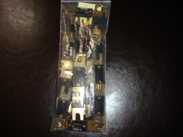

I also picked up a few dozen 300a fuses.

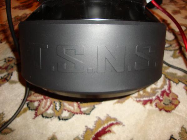

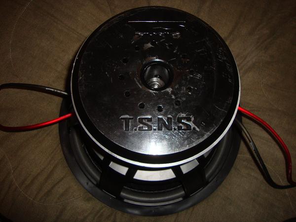

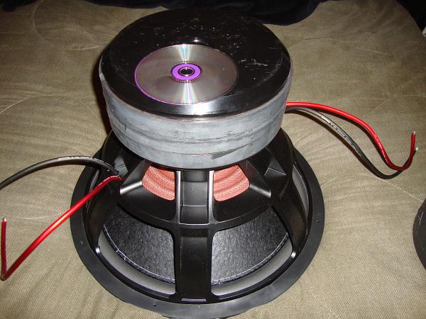

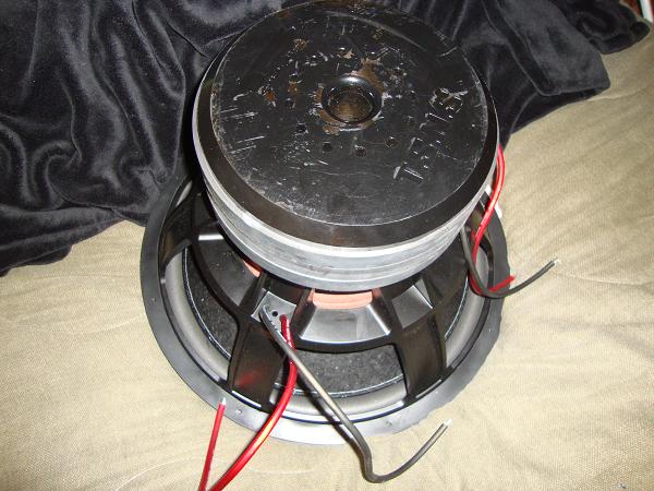

Oh shiz, something subwoofer related in the sub forum?! First sub came in today, all I can say is wow. I've installed 1st and 2nd gen BTLs, Wardens, Solo-X'18s, and this is the beefiest feeling/looking sub I've ever used.
This is D2, and GP option. The suspension is amazingly soft from what I expected, feels like a broken in Fi Q as a comparison, not like what you'd expect from an SPL-oriented sub. I'm going to test a lot, but if it doesn't like more than 5kw I wont get a 2nd amp... maybe.
There is very little info and few pics circulating, so here are a ton of pics: T3 TSNS 18 D2 GP option, all black.
No joke, it was pretty well packaged compared to other subs I've owned.
Rubber boot for motor
I got it for such a low price I was aware it could have some scratches on the motor- it did but no big deal as it's just cosmetic and hidden.
I wasn't sure I'd like the carbon fiber look, but it looks great in person. Makes the sub look bigger too, my brother asked if it was another 21.
Box build starts tomorrow.

from the motor size/cone size ratio, it looks like a 10!
BEAST!
I bet that thing weighs like 70 pounds.

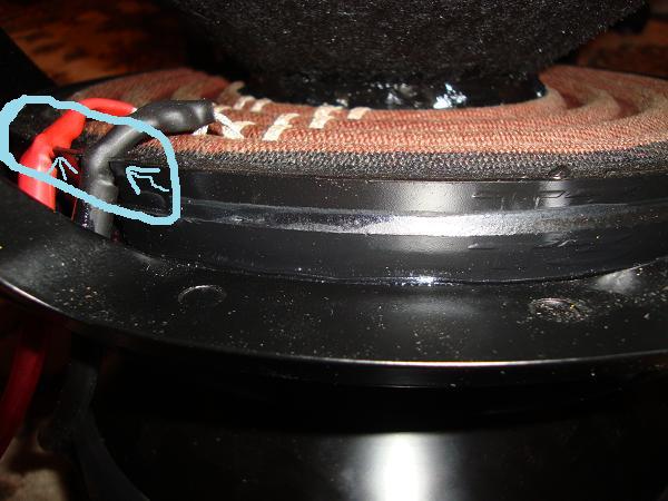

Also, where the leads turn and go on top of the spider, it looks like an accident waiting to happen after it starts flexxing and rubbing a bit, like it would rub through. Is that how it came?
Post Number: 2695
Registered: Apr-07
Thanks Eric, I really like the look of it overall, probably my favorite sub I've owned looks-wise, but that doesn't mean a whole lot for performance.
Death- they offer two basic options, daily and spl- I went with daily. I'm not sure if that was a god idea after seeing how soft the suspension is- but they say it'll handle 5kw fine. I'm going to find out soon, and decide if I need to recone when ordering the other 3 subs.
The motor diameter is like 10.5", it's beefy as crap compared to any other sub I've used. The Warden motor was fancier looking, but this just has so much mass it's impressive.
Shipping weight was 102 lbs, packaging felt like about 10-15lbs. It has a 75lb motor, so figure probably 85lbs give or take. I see no problem with the leads, they're sewn not sitting on top of the spider.

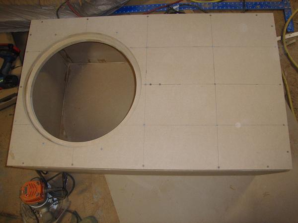

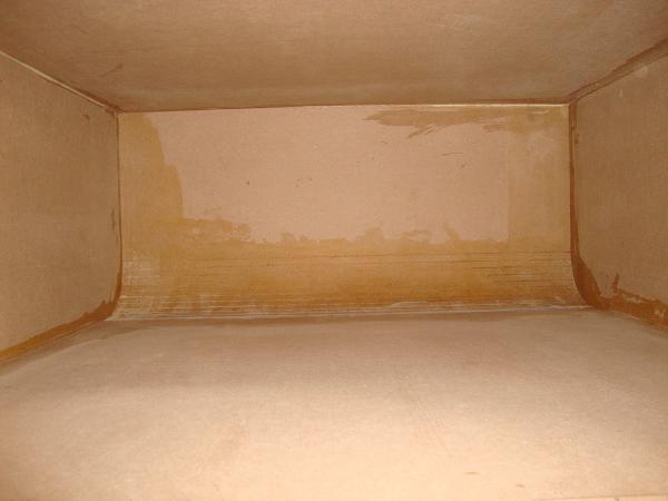

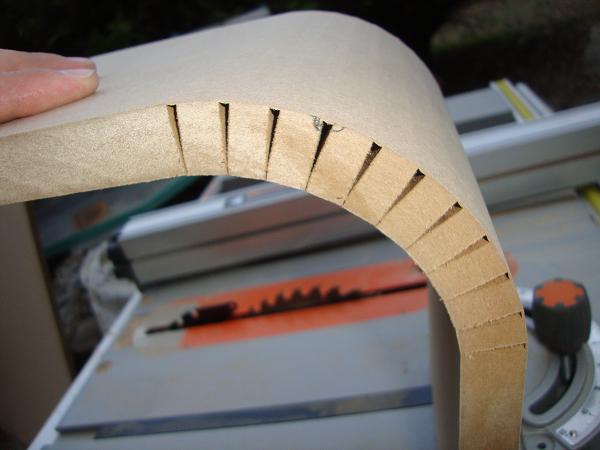

I got the wood cut, and sides/port assembled. I just need to add the top, bottom, and cut the sub hole and I'll be done. Not many pics as this is just a test box and maybe only an hours work. I should finish tomorrow and hopefully have it playing.

This is what I'm talking about. It seems like once the spider starts flexing, and the wire starts rubbing, the sharp metal edge will rub through the insulation.
Diamond Member
Www.stainles... .ecrater.com
Post Number: 24364

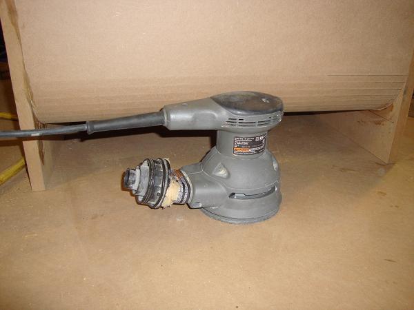

I find it amazing that the clearances on those kerfs didn't break. They look like 1/32"!!!!!

There really shouldn't be much if any movement at that point, but I'll find out.
They're pretty close to that Paul, thicker was just too hard to bend, I made it thin enough it folded easy. I figured thicker was more likely to split/crack. This is the fastest I've ever assembled a box, period. Maybe just more practice but 1/2 of that hour was making the first cuts, I had to pick the big sheets of 3/4" MDF up and cut with no help so that took a while. Also the staring while drinking redbull was time consuming

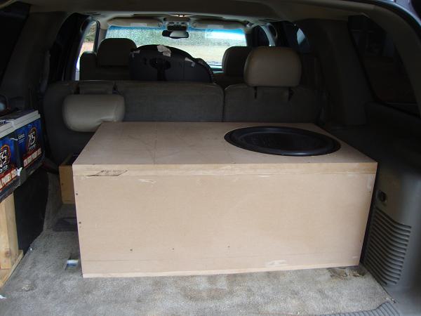

I soldered into the wiring for the sub, pulling random 8g from my bin-o-wire. I have no clue where I got this, but it's called Amp King. It's the copper on the right, vs the tinned Raptor on the sub.
I didn't plan on doing anything fancy with this, but I couldn't help but flush mount the sub.
2x4 bracing, a little wood filler in the port to cover the holes, and the box was ready to put in.
It got dark so I'll have installed pics tomorrow when it's light out. I was able to carry and lift the box into my truck with one arm, no lie. I asked my neighbor to help me lift the sub in place, god help anyone putting one of these in a wall or something.
I got about 10 minutes of low volume listening with no tuning. At low volumes it didn't get the kick-drum in the Devildriver I was listening to like I expected. On smoother bass lines and rap though it sounded great, not very peaky at all, and had a nice warm fill. I'm excited to see how it sounds with some power behind it.
My neighbor isn't into car audio at all, and said he was amazed by how nice the sub looked. Also that it was the 'heaviest speaker' he had ever seen.

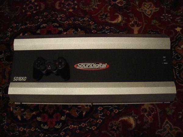

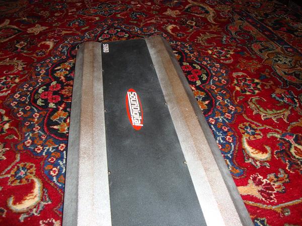

I had to ship my 1000.1 out, but at least the 16k is that much closer to being in! In the mean time I couldn't stand being without bass, so I decided to hook the sub up to my 4ch amp, using the rear two channels bridged. This is 150rms @ 4 ohms before rise, which I expect clamped numbers to show below 100 watts actual power.
OMFG this is loud for the power! I'd bet a 140, my dash is flexing a ton, my side mirrors move a lot, my rear view mirror keeps falling off the windshield mount. The wipers are moving, the windshield is even flexing a little, with my cup holder bouncing things around a bit. I did not expect this sort of output for the power!
It's a weaksauce paper trick, but imo it's getting down for the power it's on! I feel that no one can say this sub needs thousands of watts to get loud, as I've installed bigger cone area/higher power setups that weren't this impressive. It's a crappy cell vid but the flex surprises me every time I turn it up.

What I've been working on a little at a time. Gloss white 240s, 150-180 idle and 240 peak.
I'm not sure if I should leave the pulley natural aluminum, or black. Any thoughts?
Username: Joebruce
TC Sounds/DLS
Post Number: 3305
Registered: May-04
I think a black pulley with that white alt would look sick! Go for the gloss black!

especially with the black on it already, black belt, probably black 5.3 liter chevy motor plastic cover.....
Post Number: 2723
Registered: Apr-07
Thanks for the input!
I'll get some pulleys done black early this week. I'm hoping the powder coating works well - the next batch will be anodized but I have so many in stock right now I don't want to run more and have to worry about storing them .
It'll be black pulley, white front, black center, white rear case, with black plastic cover. The bracket will be gloss black.. Makinblack, the belt is green which doesn't match anything, but works well.

I got word I may have that 16k by next week, even 4 ohm testing with that amp should get me some nice results. Either way I'm excited. Hopefully by summer I'll have the build finished, but it will definitely take a while with everything I want to do
Anyway, I should have at least 4kw on the sub soon.

Better than having it stolen- but I was around till 4/4:30pm and got back at 5:30. FedEx wont even let me pick the package until tomorrow afternoon after 1 pm, and their hub is about 20 miles away. Anyway, I should have the amp here tomorrow, though if it had come in today I would have it installed tomorrow. Looks like I'll test things out this upcoming week.
I dropped my spare tire and designed 2 separate battery racks. One holds 3 batts, the other 5, so I can use one or both for a total of 8 D3100s in the spare location. I could probably have fit 10 but my dual exhaust is routed in the way, and I don't need 10 batteries so I have no plans of relocating. I hope to get the 3 battery rack welded this week, though I'm not sure if I'll have any time. Also I have to get my quad kit back on before doing much with the amp.

Anyway- pics!
Should be about as much power as 2 of my AB1000.1s after rise and voltage drop. It's the same size as an ab500.1 give or take too.
Username: Rovin
1 15 = 153 DBs ...Trinidad & T...
Post Number: 16941
sweet !
looking forward from a review concerning its musical quality compared to others u have owned
earlier this yr got to see\hear a 8k in action compared to a 7k cactus - direct swap i couldnt hear a difference - enclosure was high tuned like in the 40s so thats based on what i heard with that particular set ....
Post Number: 2736
Registered: Apr-07
I'm looking forward to it to. It's going to be tough to make a comparison until I get more subs, just because I'll be using such different equipment. Ratings wise though this one amp is like all 4 Memphis 4kws. I guess it'll be a great comparison to 4 btl 18s on 4 4kws.
Until I get on the meter I can't compare other than to the ear, which there may be a db or 2 difference I may not pick up on.
