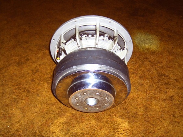

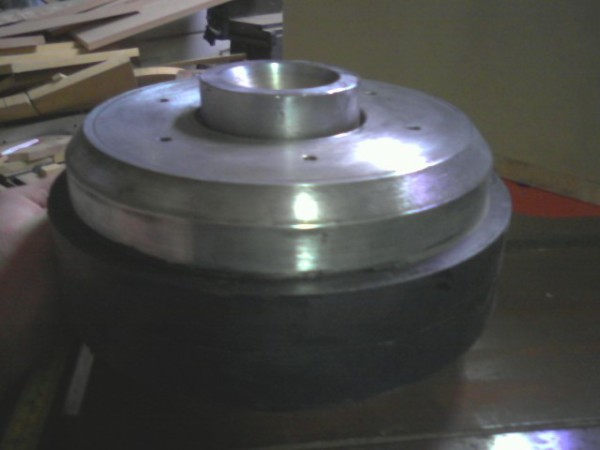

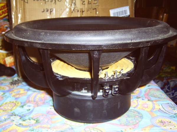

Bought the APX as a 10" last spring that was in need of a recone. Recone kit was ordered from David Moore aka Team PSI. Anyways on with the pics...!!!
Here's some pics of her a lil 10", all that glue was a pita to clean off the motor.

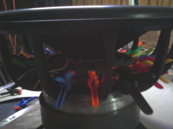

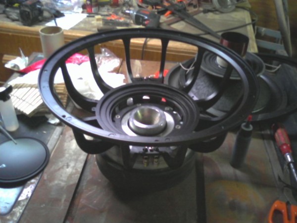

On with the recone...
Cleaned the motor to bolt on the new basket
Shims for the gap
Username: Somedonniedude
Illinois Braaap MX
Post Number: 2906

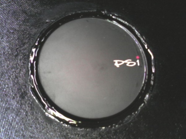

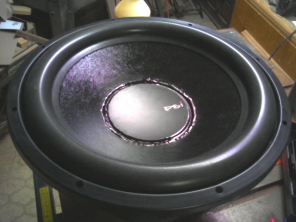

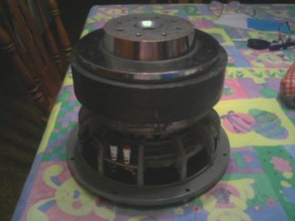

Titebond II was the perfect candidate for weight
Isn't she cute?

Sure, did you make sure the VC scrapes the pole piece?!
Illinois Braaap MX
Post Number: 2908
^ ya I made sure that they made a good connection

@ mark, them lil cheapo clamps came in handy. Hopefully start on the box in a few days. Going to be ran on my AQ2200 @ 0.7ohm for right now.
Thanks guys for the comments. I played it free air today and everything seemed solid

Some tools are both useful and cheap. Nothing wrong with a $1 clamp if it not only does the job but doesn't hurt your feelings when it breaks.
And those will break.

That gap looks super tight -- 4 layer coil ?
I re-coned an older Atomic motor recently and it had only 0.5mm clearance on both sides of the coil with a 4-layer... silly tight!
Illinois Braaap MX
Post Number: 2917
Yup 4 layer. the gap is ignorant tight! the gap is 81.8m in diameter

lol.. i just noticed that the clamps kinda match the tablecloth. lol
Illinois Braaap MX
Post Number: 2919
ya we like to color coordinate our clamps and table cloths.
