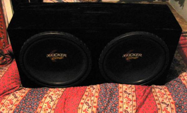

Bronze Member Username: Liljohn88Post Number: 19 Registered: Nov-05 | heres a picture of what i got ![]() |
