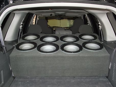

Bronze Member Username: John8x12Post Number: 83 Registered: Aug-05 | I'm not trying to explain anything. I'm just saying he does NOT need an alternator. Depending on the amps he picks, he may need batcaps. Which is still cheaper. My system now is 8 Infinity Kappa Perfect 12"'s. Two Solid Audio 1,500 watts pushing them. Four 5x7 Kappa door speakers, two 6.5 Kappa speakers, and two tweets. Mids and highs are being pushed by a 900 watt Solid Audio amp. 3,900 watt total. Stock alternator. Using a yellow top battery. STOCK STOCK alternator. Used for daily use and winning comps. |

Anonymous | that explains 150db with eight 12's no different then 300watts louder then setups with 1000 watts nice box by the way |
Bronze Member Username: John8x12Post Number: 87 Registered: Aug-05 | Yeah, I may build a ported box for the next competition. But that will take up a lot of room. Plus, the bass sounds so crisp now it brings a tear to my eye. I'd hate to kill that just to try to break a record. Thanks though. Question. Ideas on how many db's would add if the box ^ there was ported. My experience I thought maybe 2 or 3 db's. Someone in one of these threads said up to 6 db's. I'd just like to hear opinions. |
Bronze Member Username: MrmbqPortland, OR USA Post Number: 31 Registered: Aug-05 | John, You can justify the price of 8 Kappa Perfects + the amps and not the 200-300 dollars for a nice alternator?? On top of that you like the sound of Bose?? Explain. I like your choice in subs. Do they all share the same air space?? I have found that they perform better w/o sharing air. |

Bronze Member Username: John8x12Post Number: 94 Registered: Aug-05 | Problem is...each upgrade I do I think it's done right. The one I have now works great, but I want to break Oklahomo's SPL record. I'd love to compete down in south Texas; but at $2.50 for a gallon of gas, it's just not worth it anymore. Not even for the big event in Houston in July. After my next upgrade I'm going to be in the trap of having a bad a s s SPL system, but then I'll be missing my bad a s s SQ system. I guess it's a viciouis never ending cycle. Anyway, 03 Ford Expedition. 4.6 V8. You know of a good alternator cheaper than $450? I was thinking going with Ohio Generator's then I would never have another power problem. That route just gets expensive. |
