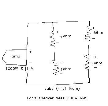

Ok, I just spoke to two more car stereo stores. The told me the same thing as before. For example:
4 Subs, each has 4 DVC, each is wired down to 2 Ohms per sub.
They are set up in a parallel series combination; 2 subs are in series, which is in parallel with the other two subs. The other two subs are in series alsoThis is what BOTH car stero places came up with: if the amp is a TRUE 1200W RMS amp, then EACH sub will see 300W RMS at full power. The WILL NEVER see 1200W. One sub by itself will see 1200W RMS, 2 subs would see 600W RMS, 3 would see 400W RMS, and 4 will see 300W RMS.
I am at work and cant create a pen and paper circuit, but I will and try to work it out myself. Although, I need to know the voltage coming out of the 1200W Amp, anyone know the Voltage out of an Orion 1200D?
Username: Karthalin
Tacoma, WA USA
Post Number: 54
Registered: Dec-04
I managed to whip this up real quick, forgive the childish look of it.

Okay, I found my mathematical formula for the circuit. In case where 2 subs are connected in parallel, the voltage does not get halved, only current does because each sub is connected to the same source.
Username: Karthalin
Tacoma, WA USA
Post Number: 55
Registered: Dec-04
ok, so how many watts does each sub see? I know that each sub sees the same current and voltage, but what are these numbers? I just asked a co-worker who has a BS in EE from Univ. Wash, and she says we really need to know the voltage from the amp, but yea, each sub will see 300W RMS

Okay Casey, according to my calculation, 300W rms to each sub since voltage doesn't drop except current. Just to double check the theory, I ran couple of speakers rated 100W.
With resistors, the voltage and current behaved as predicted. However, with speakers, it's not matter of numbers. I applied around 100W to one speaker and then connected 2nd speaker in parallel. You would think each speaker should be getting half the power right? Well I'll you one thing, the speakers behaved like they was about to burst. It didn't matter that I added 2nd pair in parallel.
So I'd be surprised if your 300W speakers didn't behave similarly.
From now on, I'll advice people that in THEORY, speakers connected in parallel will divide amp's power.

in parallel you halved the load which doubled the current draw, and thus doubled the amplifier's total power output. you would up giving each speaker about 100 watts, Isaac.
When you have one speaker getting 100 watts, then you add a second speaker, thus doubling the power, and doubling the speakers, you increase SPL by +3dB for the added power, and another +3dB for the added driver displacement. That's a considerable increase in SPL, really.
This is why it's important to understand Ohm's Law.

PS, you are technically still dividing (current) between the two subs. You've just doubled the amplifier's output at the same time, so it's now a 200 watt amp, and you're sending 100 watts to each speaker.
This may be part of the confusion as well.
