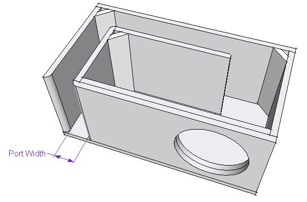

Gold Member Username: Joe1234Post Number: 1295 Registered: May-09 | Ok so let me know if the external dims fit: Enclosure Specifications: Fb = 35 Hz Vb = 4.019 ft^3 External Height = 18 in External Width = 29 in External Depth = 23 in Port Width = 4 in Cut List: * All Dimensions in Inches. * Wood Thickness is 3/4 for all Parts. External Enclosure Parts: Front = 24 1/4 x 16 1/2 Front Internal = 22 3/4 x 16 1/2 Back = 29 x 16 1/2 Left & Right Sides: Side 1 = 21 1/2 x 16 1/2 Side 2 = 22 1/4 x 16 1/2 Top & Bottom = 29 x 23 L Port Internal Assembly Parts: Front to Back = 19 1/2 x 16 1/2 Extension = 3 1/2 x 16 1/2 ![]() |
Silver Member Username: EricmbWaycross, Georgia United States Post Number: 340 Registered: Nov-08 | on the part under L port internal assembly parts, the extension part is confusing me. whats the 3 1/2 for? shouldnt that be 17.5? and should the measurements for the extension and the front to back be switched? but man is that nice! thanks alot for that. ill be sure to give you props when i build it... |
Gold Member Username: Joe1234Post Number: 1296 Registered: May-09 | Ok, the pic is just to show you how it all assembles, and to show how to apply port airflow optimizations. None are actual dimensions. The extension length in the pic is much longer than the 3 1/2 " it needs to be. Also the above is a preliminar spec, you should check the external dims to see if your cousin likes them. It can all be changed, in fact he could try a permanent install if there's enough space on the back. |

Silver Member Username: EricmbWaycross, Georgia United States Post Number: 341 Registered: Nov-08 | ok thats what was confusing me. i didn't know that the design wasn't a scale of the measurements. but hey joe, im gonna pm you a question.. |

Gold Member Username: Joe1234Post Number: 1299 Registered: May-09 | Right that was set for a 2:1 T port, the following is for a standard L port, anyhow what's important for now is if the external dims are suitable, I usually submit a number of preliminar specs until everything is just fine and double check the final one: Enclosure Specifications: Fb = 35 Hz Vb = 4.045 ft^3 External Height = 18 in External Width = 29 in External Depth = 23 in Port Width = 4 in Cut List: * All Dimensions in Inches. * Wood Thickness is 3/4 for all Parts. External Enclosure Parts: Front = 24 1/4 x 16 1/2 Front Internal = 22 3/4 x 16 1/2 Back = 29 x 16 1/2 Left & Right Sides: Side 1 = 21 1/2 x 16 1/2 Side 2 = 22 1/4 x 16 1/2 Top & Bottom = 29 x 23 L Port Internal Assembly Parts: Front to Back = 17 1/2 x 16 1/2 Extension = 4 1/4 x 16 1/2 Assumes a driver displacement of 0.22 cubic feet and 0.05 cubic feet for bracing displacement. |
