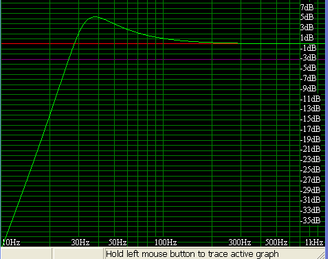

Ok, here are the:
1) SDC2.5 15" 4cuft33Hz
2) HDC3" 15" 4cuft33Hz
Normalized gains for each:
1.
2.
When tuning for a sub is too low for it. the gain will dip just above the tuning frequency and then recover afrterwards.
