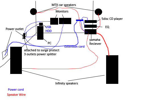

  New member Username: Badman5IL Post Number: 2 Registered: Sep-12  | Im not home yet buy when i get home i will try plugging in the receiver to the same outlet as the computer. I will add more details later. This is my system layout.  ![]()  |
  New member Username: Badman5IL Post Number: 3 Registered: Sep-12  | I hope i can double post because i cant edit that message above.  I figured it out! No more humming. What i did is i plugged in the computer into the EQ and the EQ into the main reciever.  |
