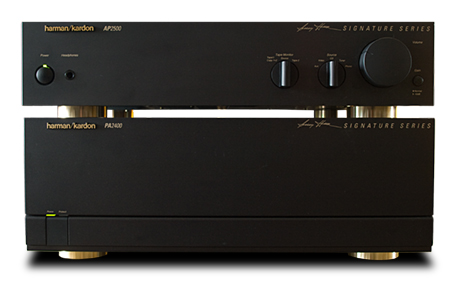

Platinum Member Username: InsearchofbassPost Number: 17222 Registered: Jun-04 | Its not a integrated amp it needs a preamp. I recieved it yesterday. Well I did want one with a dac but i dont have too and yes i need one with a cd input if i go the non dac route. 300 - 400 would be my budget but if i need move up i will if the sound quality demands it. I found a adcom gtp 750 is that a good choice for $250? I dont need phono. Heres a picture. |

Platinum Member Username: Jan_b_vigneDallas, TX Post Number: 17395 Registered: May-04 | . Most any pre amp will drive the HK. If your CD player has variable output controls, you don't even need a pre amp. Just run the variable outputs straight into the amp and use the CD's control to adjust volume. In general, stay away from pre amps built before 1985 as most line inputs of that vintage or earlier would tend to overload with the 2V output possible from most CD player's line level outputs. I would not buy a pre amp with a built in DAC since the DAC will be outdated long before the pre amp would be. But you can buy DAC's that can serve as a pre amp if you want. Beyond that, if you want a pre amp to influence the "type of sound you get", you're going to have to be fairly specific about the type of sound you want. Just buying an Adcom because it fits your budget doesn't quite meet that criteria. There are plenty of sites which sell pre amps; used, new, good, not so good, with high quality headphone outs and without headphone outs, etc. You can probably find that HK pre amp in the photo if you shop around. What do you think you want? Do you need low impedance outputs to drive long cables? . . |
