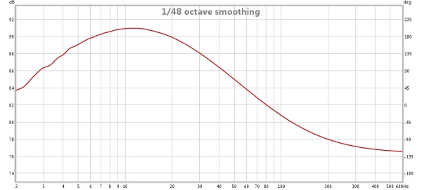

Platinum Member Username: Jan_b_vigneDallas, TX Post Number: 15685 Registered: May-04 | . Andre, you've never once mentioned any sort of room treatment devices. Until you do something with the room, it doesn't matter how many drivers you put in the space trying to minimize room nodes, the room will fight you and it will win. You have to go about this logically and IMO all you've done so far is go about getting the largest amplifier and the biggest driver and enclosure you could find. When the screw doesn't fit the hole, getting a bigger hammer isn't the solution. You can solve some of your problems with placement but the room still has the same dimensions no matter where you and the subwoofer sit. Items in the room resonate at harmonic frequencies of the fundamental or of other harmonics. A tea cup full of liquid is not likely to have a resonant frequency between 14-20Hz. It is likely to have a resonant frequency at some upper harmonic of those frequencies. Which means just because your spec sheet told you the driver/enclosure could produce 14Hz, the tea cup's resonance doesn't prove that it is capable of doing so inside your room. EQ is seldom the solution to more than a gentle tweak to a single frequency issue. If you have a null so strong you hear nothing in one location and almost nothing in another, EQ is a waste of amplifier power (no matter how much power you have on tap) and is more likely to cause other response issues than it is to solve the ones that already exist. The bell and slope of any EQ are going to be too broad to effectively deal with the problems you describe. I seem to remember you having a parametric EQ which is beneficial but often limited in just how many corrections you can make to an area such as "deep bass". A graphic EQ is all but worthless in solving room issues. What have you done regarding research into solving your room problems other than using an EQ and installing more subwoofers? To begin with, all the tympanic surfaces you mention need attention and then you need some serious absorption devices which bring with them other issues of dynamic attentuation. I think you have the wrong screw all together and you need a sander instead of a hammer. . |

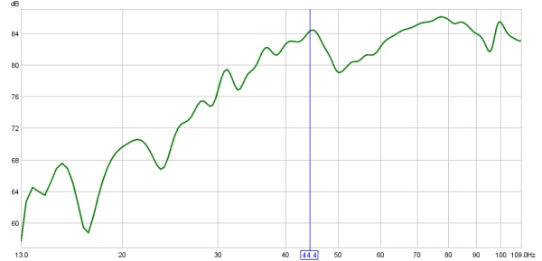

Gold Member Username: MagfanUSA Post Number: 1970 Registered: Oct-07 | Andre, you mention having 3 bass sources at 50hz+. To determine the contribution of each you may shut them off 2 at a time and see what just the one driver does. Look for peaks / nulls in your fashion and keep track of what vibrates. I don't know if such an equalizer exists, but a 1/3rd octave from say...10hz to 80hz may be able to help. But only at a specific listening postion. it'll be worse everywhere else. What are your basic room dimensions? LxWxH Where is you LP in relation to the walls? Didn't I tell you a couple years ago you were going to shake your house down? |

Gold Member Username: MagfanUSA Post Number: 1971 Registered: Oct-07 | First paragraph of Jan's #15685 is the 'clue'. Can't fix bad dimensioned room with EQ. I would just add that perhaps you CAN fix such room, but only at a single listening position. The larger the sweet spot you desire, the less exact your EQ result will be. Room treatments? Mandatory. Again, what are the basic dimensions of the room? If any 2 dimensions are a multiple of another dimension or the room is square, that's a problem. A smaller sub is not an option for Andre. Besides, if the sub and LP were located in the same locations, you'll end up with the same problem. |

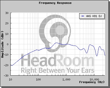

Platinum Member Username: Jan_b_vigneDallas, TX Post Number: 15700 Registered: May-04 | . Andre, I'm guessing what you're showing here for the headphones has been lifted from the retailer's site and probably comes from the manufacturer. Using that response curve as a model for your subwoofer will probably not give the results you are hoping for. Headphones deal with quite different perceptual issues than do speakers, the most obvious and most important here is the fact phones are measured and heard in the extreme nearfield. In such a situation a declination of -10dB at 40Hz (referenced from 100Hz) and -22dB from the midrange region would not be an issue. However, in a room, taking into account room gain and the fact very little can actually be done to smooth in room bass response beneath about 70Hz, that response curve is going to sound quite wrong and will never be achievable in reality. " ... the bottom is the response of my amp with the bass-boost engaged." With the "bass boost on"?! Why? Why complicate things more than you already have? Then you add EQ in on top of that bass boost? You've got to be kidding me. Where are you getting the frequency response specs for the albums you mention? Andre, what I see you doing is making a lot of excuses for why things aren't the way you want them to be. " ... the Q of the driver seems to be slightly lower than that of the generic specs", "I'm more suspicious of the speakers than the room because they are old and cheap. Magnets lose charge, materials change in properties, and factory specs change, as well as low quality control and high variation at low prices." Magnets do not loose their charge in the amount of time you're dealing with, materials are pretty stable over time - particularly poly materials, paper is stable for the most part other than humidity changes, caps and other filter elements aren't going to be suspect for twenty years and even then the tolerances are quite broad to begin with and not to be concerned with if you have a baseline to start from, factory specs can be held to within +/- 5% using modern manufacturing techniques, the "Q' of the driver you purchased is more likely to be held to a +/- 2% tolerance. The saying, "It's a poor craftsman who blames his tools", is apt here, Andre. Stop looking to other things to make excuses for the problems you are encountering. None of the "issues" you brought up should have any real world affect on what you are dealing with. "Maybe I'm just not thinking right... " I would tend to agree. You have some pie in the sky concept you wanted to accomplish but you lacked the skills and the knowledge to pull it off. Join the club. I know several of us had made comments regarding learning from your mistakes and not to expect perfection just because you have a lot of toys to play with. It appears to me you've just run smack into that wall at 120 mph. It also appears to me you've exhausted your resources when it comes to dealing with your problems. Here I'm not sure what to suggest other than what I believe has already been suggested and that is to head to a forum where there are more speaker designers to provide assistance. There simple are not enough people here with hands on experience in what you have to do you much good. I will tell you I think one of your biggest problems is your reliance on numbers that come out of either a machine or a book. To my knowledge you've never taken a measurement of the subwoofer's actual response outside of a room. Nor do you have any idea what the response of your room is other than what your modeling software suggests. Now you put two unknowns together and you are struggling to make something work when you have no reference point from which to observe changes. So you move this and you measure that and you model something into the computer that really means nothing. My guess is your computer software doesn't include items in the room such as filing cabinets, windows and doors or the fact the room flexes in real life. My guess is your modeling software assumes you have a perfectly blank cube with infinitely solid surfaces. Other than the presence of Ethan over at RealTraps I think one of the dangers of that site to you is you will get yourself sucked into all the numbers and calculations and you'll ignore the basics of making your room work with you. Once you do that you'll just have more numbers in your head but no real solutions and you'll head further and further down the rabbit hole. IMO, Andre, you need to step back from where you sit and start over at the beginning. My recollection is you made your enclosure to the specs provided by the manufacturer. But you never checked the system outside of a room and away from any reflective surfaces to ensure the response was where it should fall. You don't have much of a grasp on the response of the room other than what you measure with a subwoofer you aren't certain of and what you model into your software which is incomplete. But you aren't getting good results from the software due to the room shape and the existence of real world living arrangements. So, how long do you think you can continue to move the sub and your chair around before you finally give up out of frustration? As I've said, you have to deal with the tympanic surfaces within the room - including the room itself - before you can actually move forward rather than just sideways. Domestic rooms are not designed or constructed to support the type of bass response you want to achieve. If surfaces bend, absorb, reflect or resonate, you'll have problems. Taking measurements in such a room is a fool's errand. You have no baseline to go from for either the room or the woofer. Take out those file cabinets and do your measurements and you'll see a totally different room. Support the floor to add rigidity and you'll have a different set of measurements. Deal with windows and doors which are the most deletrious additions to any living space when it comes to deep bass response and look at the results of your measurements afterwards. But with those things undone, you're just a hamster running forever in a circle inside a spinning wheel. Let's keep you away from Ethan over at RealTraps for now. Here's something from Jon Risch which is affordable, easy to accomplish, effective and safe when constructed as suggested; http://www.audioasylum.com/reviews/Accessory/DIY-by-Jon-Risch/Quick-and-Dirty-Ba ss-Traps/general/50/501157.html http://search.yahoo.com/search?ei=utf-8&fr=slv8-hptb5&p=jon%20risch%2fbass%20tra ps&type= You have to deal with the room, Andre, there's nothing else that's going to begin to actually solve your problems. Keep in mind the diameter of the trap will be relative to the lowest frequency it can affect. There are no realworld treatments which can affect frequencies beneath about 60-70Hz as the dimensions of the trap become overly obtrusive in a domestic setting. A good 60Hz trap will itself be approximately 48" in diameter. (Don't mess with rigid fiberglass at this point, don't overthink or over-attempt at this point. Bundled fiberglass is effective, cheap and easy to come by and deal with. Just work outside or in a garage, use gloves, wear long sleeves and eye/nose/mouth protection; don't ignore this warning or you will be sorry.) The good news is you can affect dramatic changes in bass quality and perceived performance by treating those midbass frequencies. Most music performed on acoustic instruments does not possess as much energy at the fundamentals as it will at the first harmonic. Treating the 80Hz response of the room will bring the 40Hz response into sharper focus. If you're getting your frequency information for the various albums as performed by electronic instruments, then you may never achieve smooth response as most electronic instruments do have high energy at the fundamental. Put things into prespective. This is were your numbers and charts need to get tossed out the window. You have to realize what you see predicted in all of these ideals is seldom if ever going to be a realistic situation in a real world room in a domestic setting. Until you place these woofers in a theater sized room without the obstructions of a domestic living room, you are not going to manage the results predicted on paper. No flexing surfaces in a theater, right? Concrete everywhere. No filing cabinets. The space has been treated acoustically for the best frequency response. You don't have that situation, Andre, and therefore you cannot expect those results in your room. Do what you can with what you have and ignore all the numbers that tell you something else is possible when it isn't. Start with a few DIY traps in the corners behind the system. Then use your ears to determine the best location for the subwoofer. You know how to do that, right? Add more traps as resources allow. When it comes to bass frequency response, you cannot have enough absorption in a domestic setting. Each additional trap will in effect take the room more and more out of the equation making the room appear larger to the subwoofer - very much like stuffing an accoustic suspension enclosure. The danger in stuffing a room comes from the absorption of both upper frequencies and the dimunition of dynamics. Absorption is broadband and you cannot aim it at a specific frequency, you have to use a scattergun approach and in the end you will tend towars an overall smoother response curve. By removing the spikes in the mid and upper bass range you will perceive better overall performance even at those frequencies which the traps cannot affect. Absorption's largest detriment to many people is the issue of dynamics. "I still don't have 115dB reference output capability from my sub ... " And you probably never will in that room. The room is still fighting you and compression is the result of the buildup of pressure due to excessive bass being input into the space. Absorption here will actually assist you by lowering the overall pressure in the room. You will perceive and very likely measure an increase in dynamic power with traps in the room. You'll get excited about the results you achieve with bass traps and then you'll tip over into the region where you have overdone the treatments when it comes to having a good mix of live and absorptive surfaces. This is what most people do with traps and another reason I would prefer you stay away from the RealTraps site for now. I have a very good idea how they treat rooms and IMO they overdo the treatments to achieve what they feel measures right in terms of frequency. In effect they kill the liveliness of the space and leave you with a flatter response as the tradeoff. Start with the things I've mentioned, Andre, then report back after you've done some experiments. I promise you things will get better with room treatments - if you don't go overboard as a result. http://www.stereophile.com/content/era-acoustics-design-4-loudspeaker-sub10-subw oofer-measurements http://www.stereophile.com/content/science-subwoofing What do you intend to study in college? . |

Platinum Member Username: Jan_b_vigneDallas, TX Post Number: 15704 Registered: May-04 | . I would think your software has the capacity to do some curves for room response. You'll need a few woofers and a few locations. Take your measurements and then average out what the room is doing to the frequency response before you add your main subwoofer. This should tell you where the main, repeatable room problems exist and you should be able to then take those into account in any further measurements of the room - like, as you begin adding bass traps. Just make your locations for speaker and mic repeatable down to the 1/4". Looking at that graph (which I assume is of your sub/room) it would appear the peak at 44Hz is related to the peak at roughly 22Hz and the same at about 88Hz. The troughs follow the same pattern. Now, if that's a graph of KoRn's bassist, then it follows the pattern of how instruments deal with harmonics, though the harmonic of an acoustic instrument can oftentimes be as much as +12dB above the fundamental. So, what's that graph showing? "The modeling software does not model the response of the sub in the room. I have two programs for the subwoofer. The first models the subwoofer driver in a certain cabinet (in this case ported) and port configuration. It also takes into accoun Q of leaks, box absorption, and port absorption, as well as environmental parameters. It models SPL, phase, impedance, impedance phase, port velocity, resonance, excursion, and many other things. It is just to design an enclosure for a specific response based on T/S parameters." Yeah, that one's all but useless other than the pretty pictures it creates. You need it and nowdays you can't start building an enclosure without it but it is largely just a recipe for how to start thinking about the project. You can either follow the recipe by measuring out the 1/8" tsp. of cumin and the 1/4 cp. of arrowroot which will give you a passing resemblance to what the author intended - usually not that tasty - or you can think of the recipe as not much more than a guideline for how to bake a "subwoofer". Your problem right now seems to be you don't have the skills or the experience to draw upon to know when to fudge a recipe to obtain the results you want. That others have had better success than you could be attributed to several different factors. One could be the others didn't make this their first build and had an idea where to fudge numbers and how to make corrections for the real world. Another could be the others had a better idea of how to use the equipment they have for measurements. Or they just got luckier than you did, Andre. I don't know since I don't know their work. Actually, most of the items that software shows aren't that important to the final product as you needed to build it - certainly not as a first build project. "The second program measures the actual response of the subwoofer using a meter, all of which I have calibrated, and automates EQ settings (for a specific equalizer) for a desired response curve. It shows phase, modal, frequency, impulse response, and group delay." I'd go back again to recheck this program and make sure you have everything correctly set to minimize any user error problems. This program is still just another set of numbers though, Andre. What do those numbers mean? Without those baselines that I mentioned earlier, I can't imagine they mean very much when it comes to helping you work out the issues of the room and sub as a system. It looks like you have the recipe and you have the measuring cups, you just can't bake a cake. "There is no 'recommended' enclosure from the manufacturer for my specific application. However, many others have done the same as me with spectacular results, leading me to believe I have a build issue." If you have access to others who have built this sub, then possibly they can give you some help. My guess is you'll find they have, for the most part, not put their units into the sort of space you have. You may have a build problem but, how are you going to determine that you do and how to fix it? This is where the experience of not building the biggest subwoofer with the deepest response and the highest SPL as your first project comes into the picture. But you are where you are. I can't help you here, Andre, these are the sort of things you have to tear apart and stare at for a few days. That's usually pretty difficult with a subwoofer enclosure. I would tell you to trust the first program to have given you the basic recipe. Double check everything you can about the build and in cases such as this you generally have to decide to either make what you have work to the best of its ability or you tear everything down and start again. Without someone with more experience with this system, there aren't a lot of other choices. IMO you're still shooting in the dark however. You can't expect this sub to perform well in an untreated room. That is just a fact of life when it comes to the type of project you built. " ... the room will fight you and it will win." Not to push my agenda but from my experience, stop worrying about getting measurements to do what you think they should. Deal with the room first. It doesn't matter how the sub measures if the room undoes everything you've worked on with the sub. Leave the sub itself alone for now and get the room as right as it possibly can be. Once the room is as good as it can get, then any sub you put in the room will have a better chance of success. Realize what the programs tell you probably isn't what you will actually achieve. Use other people's experience as your guide more than the recipe. . |
Platinum Member Username: Jan_b_vigneDallas, TX Post Number: 15705 Registered: May-04 | . Andre, before you let go of the subwoofer for the moment; have you checked the impedance of the system? This is a vented system, right? Then you should be able to use the twin impedance humps of a vented system to tweak the system. If the peaks aren't measuring correctly, then you need to do some enclosure tweaking. This could be replacing a port or adding some stuffing inside the enclosure. . |

Gold Member Username: Arande2Rattle your ... Missouri Post Number: 3041 Registered: Dec-06 | Issues between 30-200 hertz have been effectually eradicated, finally managing a preset on the EQ and phase/delay settings that give great sound at the preferred listening level (in that freq range). The problem now in the bass is the ultra-low range from 15-27 hz that was the whole point of building a large subwoofer. Its presence is lacking and this is reflected on the SPL meter. There is not much point in boosting between 19-25hz it as it does not fix the problem. It merely causes rattling around the room that takes away from the effect of the content being played as well as lowering headroom. This is one reason there is consideration for moving the system to a smaller space. There should be more room gain at those low frequencies, Any music (even VERY bass-heavy) now requires ridiculously high master volume levels to exceed 100w drive levels. This is only because of the increased output sensitivity at the new positioning. The music has good energy/drive and mostly meets expectations, except for the upper range. Movies now have dramatically increased impact, but those frequencies <25-30 hz aren't making themselves known at all and it could be so much more. During the loud moments, the level meter often hits the yellow, indicating less than 3dB of headroom before the clip lights will come on (clipping is 2000w into 4 ohms) AND elevated distortion levels (which ARE audible depending on the content). At times it DOES hit the red, and the sound is badly affected. This still seems to call for a second subwoofer or more efficient setup. Aside from the area below 200hz, it is now readily apparent that the current speaker setup (both positioning and the speakers themselves) needs some improvement. These speakers are now a big limiting factor in the sound quality. The amp's fan needs to be replaced, too, because it messes up those quiet moments that are supposed to add suspense and drama. The same goes for the lighting and small TV. The realism on the visual is none. |
