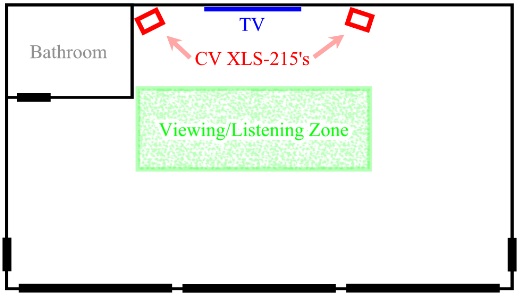

As for the placement of the speakers -- what I was thinking is attached...Upload

In regards to layout, all this is speculation because all I see is a rectangle, a bathroom and where you want the stereo...
Try to keep the speakers out of the corners. The one near the bathroom is what I'm referring to. Corners reinforce bass, but they also have a tendency to make the bass boomy and flabby sounding. Think of a car driving by that rattles when bass hits. That's not what you want. The bathroom wall is probably a hollow wall, making matters worse.
If it's possible, try them on the opposite wall, in the middle. That may be where the overhead doors are, and if so scratch that one.
If the best/only realistic wall is where you have them drawn, I'd start in the middle of that wall - half way between the bathroom wall and the right side wall would be the mid point.
At the end of the day, it's all about trial and error. Every speaker behaves differently, and every room sounds different. Add to that the best place isn't always the best sounding place, and it comes down to even more trial and error.
Proper placement will keep them from sounding boomy, sounding like everything is coming out of the boxes rather than a soundstage, and so on. I'm pretty sure you're not looking for pin point imaging, but hearing two boxes make noise sounds like crap. If you're watching movies, you want the voices to sound like they're on screen, not like they're coming from the speakers.
Set the speakers up properly, and they'll sound like you're using a center channel. I have my stereo connected to my TV too. No surround sound or center channel. When people watch a movie at my place, they'd swear I had a center channel. I had a few friends over for March Madness last year. They all said it sounded better than their surround sound systems. Not that I was asking them or bragging about it by any means. 2 good speakers placed right can sound a lot better than most people realize.

There really isnt any other place I can put those speakers.. A little more information though... I'm not done building the wall for the bathroom, however... the walls in the garage area 10' from floor to ceiling. It is a corrugated sheet metal ceiling.
The bathroom wall is only 8' tall, and is made of 2x4's, with 1/4" OSB covering. The inside at this point is hollow, however I can pad the inside with whatever needs be to assist with the acoustics of the soundstage.
What do you think?

The pics are a bit dark and it's kind of hard to tell, but I think I have a good sense of what's going on.
The best advice I have is try it out and see. You could also put the speakers on the floor in front of the bench if need be. Keep in mind that on the bench they'd be pretty much right up against the back wall, which could make them boomy in the bass. Most speakers work best at least a foot or two away from the back wall and corners.
Is the pic the actual room or a rendering? It looks pretty nice from what I can make of it. If it's a rendering and the bench isn't built yet, you may be able to get away with making it not as long as the full wall, thereby making room for the speakers. Just throwing that out there, as I don't know what you plan on putting on the bench. I'm sure you know why it needs to be that size.
Hopefully the gear will be there soon. Waiting is the hardest part of it all.
