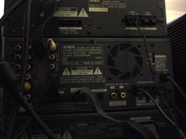

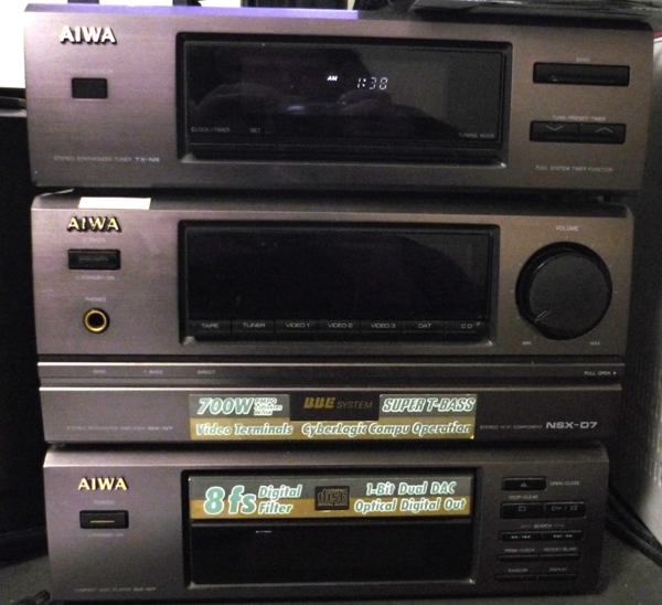

New member Username: SsmusicPost Number: 2 Registered: May-10 | Hi David, I thought as well. The Aiwa component is hard to describe since it has several modules, the main one says "NSX-D7" and "Stereo Integrated Amplifier MX-N7". I disconnected the Cassette module since I don't use it, and the voltage comes from the CD player, "DX-N7". This connects to the wall outlet and has a cable that also powers the NSX-D7. I have also connected the Tuner "TX-N9". The weirdest thing among the weird is that this sound is shown on the graphic EQ, it's like there's a feedback or something but I'm only connecting speakers! Also, I tested the speakers before buying them and they work fine. I'm sending a pic of the back of the main module and the front of everything. Sorry for the poor quality of the images but thought it may help. I haven't got the manual and searched for it online but when I found a "NSX-D7" manual it was a completely different device. It doesn't shows well but on the lower right of the first pic is where I connect the speakers, it says SPEAKER IMP: 6 Ohm ![]() |
Platinum Member Username: Jan_b_vigneDallas, TX Post Number: 14854 Registered: May-04 | . I remember that unit and the "Super-T Bass" system. Even for compact systems from the early 1990's it was funkyshit. At the time Aiwa was the "we know nuthink" arm of Sony that was allowed to come up with the really weird stuff that was always loaded with BS circuits, always had way too much crap for the price, always sold as blow out reconditioned "B" stock and always broke - again. Just read the front panel of that thing. I had been hoping never to see one of those conglomerations again! As with most rack and compact systems of the day - and I assume still today - the power supply is fed from one "master" unit to the next and to the next and to the next through umbilicals. This makes the entire unit one large ground loop as the units are typically eq'd through the feedback circuit of the amplifier (which draws its power from some other unit) to goose the sound of some pretty low rent O.E.M. speakers. The stated impedance of the speakers has nothing to do with your problem. The issue is in the ridiculous design and construction of a cheap system meant to be wholly self contained - read as; if you wanted better sound, why'd you buy this? Without the intended speakers hanging off the outputs of the amplifier to keep everything under the radar of thermal fusion the amp has an open ground loop system - 60Hz ground noise. That's what you're hearing and there's nothing I know that will fix it other than putting this system in another room or a closet and buying a cheap receiver to use with your new speakers. Upgrading this system is not going to happen. . |
