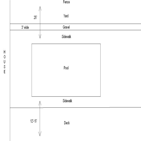

New member Username: Jpell29North Charleroi, PA USA Post Number: 1 Registered: Mar-10 | Ok, I am having a hell of a time trying to get a half decent outdoor audio solution for my pool. I have bought speakers every year for the past 5 and I am sick of spending money every year. So, I am asking for your help. This is what I want to do: 1. Get speakers for outside and not have to worry about bringing them indoors. I dont want to hang them anywhere, I would much rather put them in the ground, but Im not sure of how the sound quality will be. 2. Run cables from inside the house to the speakers outside. Need to know what kind of cables are good. 3. Would have to imagine that I am going to need an amp inside to control the speakers outside. 4. I also wouldnt mind putting a outdoor volume control. 5. Would like to look into maybe getting a outdoor subwoofer if you think thats an decent option. I have attached a VERY rough diagram of the lay out outside. I was originally thinking about plugging the speakers in the area labeled "gravel", and was thinking about getting 360 degree speakers. HELP A BROTHER OUT!! This is killing me. Any help would be much appreciated. Thanks Guys!! ![]() |
Platinum Member Username: Jan_b_vigneDallas, TX Post Number: 14637 Registered: May-04 | . Why are you buying new speakers every year for the past five years? Are you buying speakers that deteriorate in the outdoor environment? If so, you really, really need to find another dealer. Any decent shop (read not Best Buy or their ilk) can sell and advise you on the proper speakers to place outdoors. You live in PA, USA, there must be a good dealer in your area you can contact. Outdoor sound quality is always less than indoor sound quality. There are no reflective boundaries outdoors and that means you loose significant amounts of sound to the air. A subwoofer is a stop gap that is only convincing in most outdoor applications either when you are very close to it or when you are in your neighbor's house not wanting to hear the thump of the neighbor's subwoofer. If your neighbors don't care, go for it but make it a sub that goes for high volume rather than low bass extension. Outdoors you can get by with more thump and boom than you would want indoors 'cause it all sounds fairly bad out there anyway. Cables need to be burial type. You can buy 'em at any good dealer or at Parts Express on line. Buy the outdoor volume control while you're there. Who's going to install all this stuff? Buy directional speakers - not "360°" speakers. You want to aim the output of the speakers at the areas that need coverage and place them under the eaves of the house for maximum protection. You will loose substantial amounts of volume and sound quality outdoors - I think I've already mentioned that - so you don't need to waste even more with omni-directional speakers particularly if you're sticking them up against the house anyway. You also want to aim the speakers for where you do not want coverage - I've already mentioned those neighbors not wanting to hear your music unless they have been invited over for drinks and a meal. If you simply cannot find a dealer in your area, call Parts Express. . |
New member Username: Jpell29North Charleroi, PA USA Post Number: 2 Registered: Mar-10 | Hi Jan, the issue with buying the speakers was basically I didnt want to spend $500 on speakers that when I get drunk, I forget them outside and they get ruined. Thats what I want to avoid. And as far as the speaker placement goes, I was thinking on putting them in the middle (area where it says "gravel" on my drawing). This way, you can hear the music from either side. |
Platinum Member Username: Jan_b_vigneDallas, TX Post Number: 14639 Registered: May-04 | . So how do you want me to amend my advice? I thought it was pretty clear and concise the first time. |

Silver Member Username: MagfanUSA Post Number: 955 Registered: Oct-07 | I've used PVC as conduit a few times. My small dish to house ran thru some and it lasted for over a decade without visible aging. This in Southern California summer sun. Put elbows aiming down so water won't get in. Figure it out first, run the cable thru straight pieces, thru the elbows or other connectors than glue it up with wire in place....no pulling wires later. More trouble than its worth, but I had free PVC, time and an urge to keep those nasty cables out of sight. |
