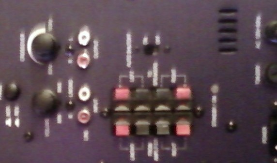

Here's two pictures of the back of the subwoofer.
The image is a little blurry but there are TWO RCA jacks. One says input and the other says output. This is a powered subwoofer, with a plug.

Here's two photos. Better quality.
http://i143.photobucket.com/albums/r126/jth0033/Home%20Stereo/0228101401-00.jpg
http://i143.photobucket.com/albums/r126/jth0033/Home%20Stereo/0228101400-00.jpg

OK, I sure didn't expect RCA outputs but anyway we go back to the beginning, connecting an RCA cable to the input with the power on should make some noise, if so then back to the receiver for correct connections and set up.

Haha, okay. Yea it does make a noise. Hmm must be the receiver then I just don't know. Like I said I went through everything on the receiver pertaining to the subwoofer. Any other help?
