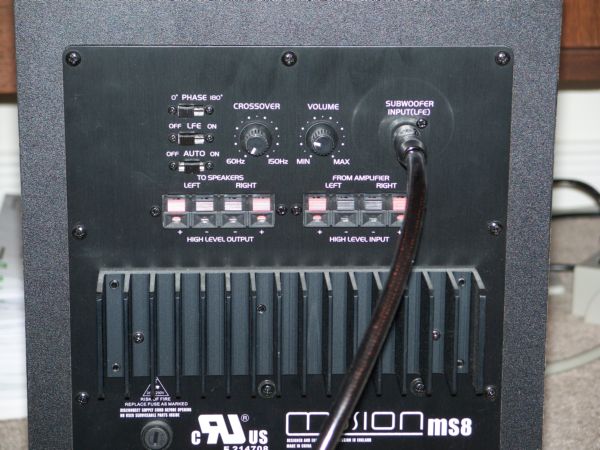

Silver Member Username: KbearCanada Post Number: 142 Registered: Dec-06 | Here's a pic of the back of my sub. How would you guys recommend I hook it up? I guess it's pretty clear that I don't have many options as there is only one input (not going to use the high level input). I'm guessing this is probably not the greatest subwoofer for high end two channel. Anyways, long run it'll be doing HT work. |
Platinum Member Username: NuckPost Number: 12736 Registered: Dec-04 | If the Denon has a lfe out, then there is no question. If not, why not the high level inputs? |
Silver Member Username: KbearCanada Post Number: 144 Registered: Dec-06 | No LFE out on the Denon, so I have to put the LFE switch on the sub to OFF. To use the high level in/out I'd have to buy another set of speaker cables, and I read that using these could degrade sound quality since you are introducing another component to the path. Just not worth it. Truth is, I've got my sub dialed in pretty good now, it blends in well with my speakers. So to me it sounds good. I'm sure when I upgrade to a more expensive unit and use two line level connections it'll sound a lot better, but until then ignorance is bliss. Can't afford to spend any more money right now. |
Platinum Member Username: NuckPost Number: 12739 Registered: Dec-04 | Just use the high level in, forget the out |
Silver Member Username: KbearCanada Post Number: 147 Registered: Dec-06 | But I like the sounds that my speakers make. If I were to use the high level in, I'd have to run my speaker cables from my amp to the sub high level in, the sub would remove the low frequencies, and using the high level outs I'd connect to my speakers. If I didn't use the outs then I wouldn't be able to connect my speakers! |
Platinum Member Username: NuckPost Number: 12787 Registered: Dec-04 | No Dan, the high in to the sub is just that, and the mains are unaffected, keep them connected at full range. |
Silver Member Username: KbearCanada Post Number: 151 Registered: Dec-06 | My amp only has enough speaker connections for two speakers (4 outputs in total). The subwoofer manual says the following about the high levels: High Level Input (from amplifier) These inputs are designed to accept an amplified signal from the speaker outputs of a receiver, power amp or other device not equipped with line level outputs. High Level Output (to speakers) The original amplified signal connected to the high level inputs is present at these outputs with very deepest bass information removed. From here the signal may continue on to the existing Left and Right speakers. I don't think I could use these connections without another pair of speaker cables. And because I'd use the speaker outs from the amp (not the pre outs) the amp would be sending the full signal. It would be up to the sub to remove the high frequencies. |
