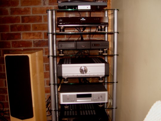

Gold Member Username: My_rantzAustralia Post Number: 1885 Registered: Nov-05 | I have put together some cheap isolation/dampening feet for my CD5i and after finding these perform better than the squash balls under our components with our glass shelving, I am getting more parts today to make the same feet for the rest of our kit. Each foot consists of a self adhesive felt pad, a rubber door stop (with a top recess for a screw) and a marble. The marble fits in the recess of the door stop, the felt pad goes under the door stop, and when put together the marble fits under the feet of the components, which I have found all have a small recess to hold the marble in place. The CD5i in particular has within the recess of it's feet a screw head which grounds to the marble - in turn any vibration entering the marble should be absorbed into the rubber door stop and any upward vibrations on the glass shelving should be dampened by the felt pad and door stop to prevent entering back into the components. That's my theory and it sure seems to work well - at least it does on the cdp. More high end detail, cleaner more spacious soundstage, tighter and deeper bass. Enough to stop me wondering about a CD555 (grin). Pictures coming soon Please post about your isolation devices with pics (if possible) whether DIY or bought. It may help others find what may be suitable for various components and shelving material etc. Thanks to Mike Wodek and Jan Vigne for putting me on this path. Sorry - devises should be devices. Can't edit thread title. |

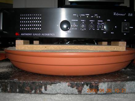

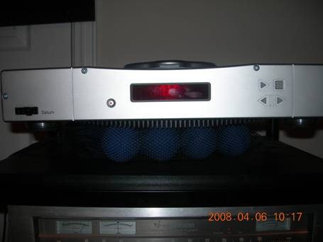

Platinum Member Username: Mike3Wylie, Tx USA Post Number: 1228 Registered: May-06 | M.R. - A couple of us were discussing Constrained Layer Damping http://www.google.com/search?q=Constrained+Layer+Damping&ie=utf-8&oe=utf-8&aq=t& rls=org.mozilla:en-US:official&client=firefox-a The first thing I would do, having done it myself now, would be to do some dense damping with the TT. I moved mine to the floor, well a about 1 1/2 ft off of the floor with isolation and damping under it, but that was what a Linn needed, not sure about other TTs. The tennis balls, racket balls, neoprene plumbing end caps, Jenga tiles, and Black Diamond Racing Cones I have used all fit in the "isolation" bucket. I have been steered toward damping recently and found that for my amps, damping works best, for my Linn, a combination of damping and isolation works best (it no longer bounces around Nuck), and I have left my pre-amp, CD player, and tuner with isolation only, much as you have with your set up M.R.. I just made additional changes yesterday to the amps and TT so I am not going to experiment with damping on anything else right now as all of this sounds too good to mess with. BTW I like the idea of using each device's feet in the equation. That is what I did with my Pre-Amp, but then I added one more racket ball and neoprene cap (slightly taller) each under the tube and phono stage sections directly. I will try to get some pics up here sometime today. |
Platinum Member Username: ArtkAlbany, Oregon USA Post Number: 6643 Registered: Feb-05 | Excellent thread... I find that you really have to experiment to find what each piece really likes. The spiked shelves on my Premier rack where the Rega sits appears to be exactly what the gear needs...anything else that I apply changes the sound but not for the better. However I'll keep trying....lol! The Rega feet are just the right size for my next attempted tweak, Golf balls on vibrapods...I'll try anything, and it's all fun! |

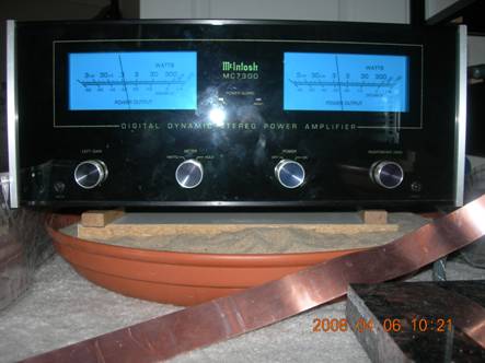

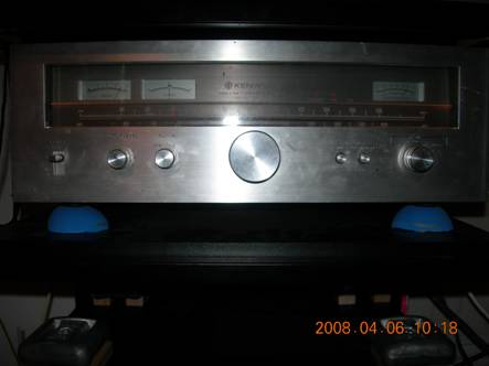

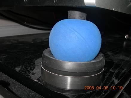

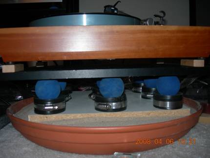

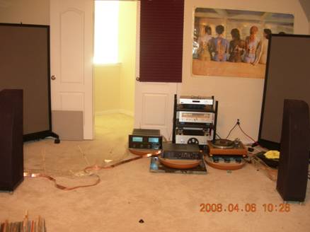

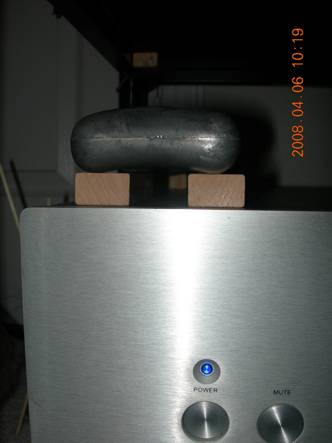

Platinum Member Username: Mike3Wylie, Tx USA Post Number: 1229 Registered: May-06 | Saturn Kenwood Isolation for Pre-amp Dampening for Pre-amp Complete Pre-amp isolation MAC CLD Set Up Anthony Gall S/A CLD Set up Linn CLD with Isolation Set Up The "New" new look ![]() |

Platinum Member Username: NuckPost Number: 10009 Registered: Dec-04 | Great pics, MW, and well done. This sould be fun...JV doesn't have a camera...shame, really. Thanks for the thread, MR. |
Platinum Member Username: Nickelbut10Post Number: 1323 Registered: Jun-07 | Awesome pics guys. M.R. That appears to be a Panny blu-Ray, when did u invest in that? |
Platinum Member Username: My_rantzAustralia Post Number: 1887 Registered: Nov-05 | Mike - from construction site to Japanese tea garden. And I bet it sounds as sweet. Great pics and thanks for that link - I'll read some more on that. I almost bought those same balls at first, but knew I wouldn't get away with them - so I got the squash balls. But these MR-feet (I'll have to take out a patent ha-ha) seem to do the job nicely. Mrs R commented on how nice the music sounded. At least I put those few loose marbles she said I had to good use. Oh, I took away the timber base for the T/T as I found in the packing box some little metal discs for the coned feet. I packed blu-tak under the discs and mounted the coned feet of the T/T on them and there was no difference than having it on the timber base. I know it could benefit from further isolation as you suggested but it does okay without upsetting the aesthetics (read Mrs R). Maybe the BD player could benefit from a little weight on top. The top panel of the A5 is a bit ringy with a finger nail flick, but I tried a reasonably weighty book but noticed no difference so maybe the feet work with that also. I got the Panasonic BD player a little while back Nick - great picture and sound abilities. Also does very good DVD-A. Art, I know you posted those spiked shelves previously - If you could post a pic ot two here it'd be good. Yeah, it is a bit of fun tweaking things and getting results. Nuck - get JV a camera will ya? |
