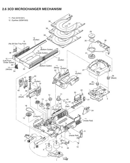

New member Username: Andres73Post Number: 1 Registered: Jul-19 | I had the same problem as the trays that were not synchronized and when trying to open the trays, they got stuck and showed me an E2 error, but yesterday I solved this problem with the help of the pioneer 839 service manual, I saw the explanation of up with the special wheel in a funny way, but everything was fine with the wheel, then I noticed that the trays were desynchronized, I returned all the trays to their initial position and then I put the charger (CD changer) in its initial position, try this but I did not solve the problem, but the trays already opened, again I returned everything to the initial position fixing that the CD player did not move according to the trays, there I noticed that a piece had been released, I put it with great care and that is like a very small spring and Wonder, everything works ok now, here in the image is the piece that is committed from number 20 to 23, and the spring and the piece that had been released from its location was number 2 1 and 22 ![]() |
