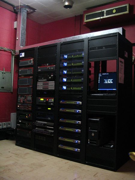

Gold Member Username: Thx_3417Bournemouth ... Post Number: 3186 Registered: May-05 | This looks promising the Behringer Ultradrive Pro DCX2496 Ultra High-Precision Speaker Management System and like the (dbx 4800 that's been installed at the Empire Leicester square as part of its THX installation), the Behringer Ultradrive Pro DCX2496 is priced normally around RRP £327.83 but at mad price of £168.99 at Turnkey yeah that positively on the list for the summertime. dbx 4800 http://www.dbxpro.com/4800/4800.htm Behringer has something along the same lines yet the cost is has high as $3K! No, this one can be picked up for $249.99 or £168.99 at Turnkey site over here in the UK. Turnkey / Behringer Ultradrive Pro DCX2496 Ultra High-Precision Speaker Management System http://www.turnkey.co.uk/web/produc...496&context=WEB Parts-Express / Behringer Ultradrive Pro DCX2496 Ultra High-Precision Speaker Management System http://www.parts-express.com/pe/psh...tnumber=248-669 So I have plans to save up and buy a few yes a few is needed to address the audio and at the price these are going for well that's a huge saving Behringer Ultradrive Pro DCX2496 http://www.behringerdownload.de/DCX...SPECS_Rev_C.pdf The ULTRADRIVE PRO DCX2496 is the ultimate digital loudspeaker management system with an unheard-of audio quality and feature list. It is an indispensable tool for the precise set-up of multiple loudspeaker systems or arrays. Installation contractors, live-sound engineers, cinemas / discotheques / concert hall operators will quickly learn to love this model's rich features. Signals can be split in various ways to assure precise sound by using the optimal frequency range of each loudspeaker. Start with its 3 analog inputs (one suitable as a digital stereo AES / EBU input) and 6 analog outputs. You get maximum flexibility in just one rack space. Superb high-end AKM 24-bit / 96 kHz A/D and D/A converters give you ultimate signal integrity and an extreme dynamic range of 113 dB. Easy connection of external digital signals with sampling rates from 32 to 96 kHz is a breeze with the integrated sample rate converter. There are precise dynamic EQs for level-dependent equalization and extremely musical parametric EQs, selectable for all inputs and outputs, and "Zero"-attack limiters on all output channels guarantee optimal signal and loudspeaker protection. You also get four different mono and stereo output operating modes, all with individual crossover filter types (Butterworth, Bessel and Linkwitz-Riley) with selectable roll-off characteristics from 6 to 48 dB/octave. The delays for all inputs and outputs are adjustable. This allows you to manually or automatically correct for room temperature, phase and arrival time differences. An additional sum signal is easily derived from the A/B/C inputs. Now that remote control is such a hot topic, you'll be glad that the future-proof ULTRADRIVE PRO software enables single or multi remote control via PC through RS-232 and RS-485 interfaces. And the link option via RS-485 network interface enables cascading of several ULTRADRIVE PROs. A Windows-based editing software is available for download free of charge. No matter what the future brings, its open architecture assures easy software updates. A PCMCIA slot allows you to store all your settings and recall them anytime you change the location-virtually taking your ULTRADRIVE PRO with you. But don't be fooled by the ULTRADRIVE PRO's sleek design. Its high-power 32-bit SHARC-DSP and ultra-high resolution CRYSTAL/AKM A/D & D/A converter provide outstanding audio performance-and the servo-balanced, gold-plated XLR connectors for all inputs and outputs guarantee excellent connectivity for the years to come. Features: 3 analog inputs (one suitable as digital stereo AES/EBU input) and 6 analog outputs for maximum flexibility High-end AKM 24-bit/96 kHz A/D and D/A converters for ultimate signal integrity and wide dynamic range (113 dB) Integrated sample rate converter for easy connection of external digital signals with sampling rates from 32 to 96 kHz Precise dynamic EQs for level-dependent equalization and extremely musical parametric EQs, selectable for all inputs and outputs Several types of EQs (LP/BP/HP) for each input and output "Zero"-attack limiters on all output channels for optimal speaker protection Four different mono and stereo output operating modes Individual crossover filter types (Butterworth, Bessel and Linkwitz-Riley) with selectable roll-off characteristics from 6 to 48 dB/octave Adjustable delays for all inputs and outputs-allow manual or automatic correction for room temperature, phase and arrival time differences Additional sum signal derived from the A/B/C inputs offers a fourth internal input signal Future-proof ULTRADRIVE PRO software enables single or multi remote control via PC through RS-232 and RS-485 interfaces (www.behringer.com) Link option via RS-485 network interface enables cascading of several ULTRADRIVE PROs 60 user-defined internal presets storable via PC software or on PCMCIA card Open architecture assures easy software updates Ultra low-noise 4580 operational amplifiers for outstanding audio performance Servo-balanced, gold-plated XLR connectors for all inputs and outputs High-quality components and exceptionally rugged construction for long life and durability Internal switch-mode power supply for maximum flexibility (100 - 240 V~), noise-free audio, superior transient response plus lowest possible power consumption |
