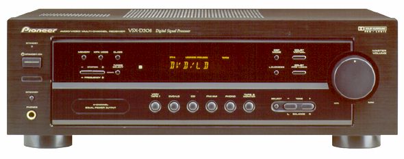

I have a Pioneer VSX-D308 receiver and what I was wondering is that is it ok to connect just a pair of speakers that are 4 ohms? This receiver is normaly for 8 ohms or higher. I attached a pic of my receiver but the color is bad mine is more black and normal color looking receiver

I don't know. My receiver from the 70's takes 4 ohms just fine (and pumps out 200w) . I don't recommend it though. Other people *Should* know.

On my owners manual it says 8 ohms or higher. It doesn't say 4 ohms is ok that's why I needed to know if I can connect just a pair of 4 ohms speakers and have no problem with this receiver or the 4 ohms speakers.

Hi dallas I actually own that same receiver, and with my experience with it is that 4 ohm should be fine, I had 4 ohm speakers hooked up for the longest time and it did just fine, Note: I have never had mine up even half way, never needed to, but you might play your a little louder than I play mine, with a quarter of the way up is what I have mine at most of the time, the 4 ohm speakers did just fine.

All four Ohm speakers are not equal! You need to know more than just "they are four Ohm speakers". What is the lowest impedance of the speakers you are considering? What sort of electrical phase angle do they present to the amplifier? Are they difficult or fairly easy to drive? What sensitivity do they have? Do they play above 90dB with one watt of power in? If you can't answer these question and cannot find someone to provide you the information, do not connect those speakers to your receievr without expecting to do some damage.

That doesn't tell us anything relative to what the speaker load when it's connected to your amplifier. No minimum impedance is stated and that's important to know before you hook them to a receiver that states they shouldn't be used with that receiver. Please understand that most four Ohm nominal speakers dip beneath that impedance at some point in their frequency range. I don't understand why, if your receiver says don't use these speakers and you have a viable alternative, you would want to take the chance on the lower impedance design. To be honest, this seems stupid. Just buy the higher impedance speaker and be happy that you are not risking your receiver.

Just buy the 8 Ohm speakers. Is there something difficult to understand about that? Why are you resisting this advice so vehemently? If you don't want advice, buy whatever you want and stop posting.

If you do try the 4 ohm, just let the receiver warm up briefly and turn it loud, see if the unit shuts down. By ramping the thing up you induce a lot of heat, and tipping a control circuit with a cooking amp section is not preferable.
