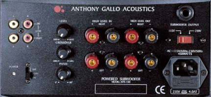

New member Username: Kc1Post Number: 2 Registered: May-06 | In case it helps, this is what the back of the Gallo Subwoofer Amp looks like: ![]() |
Gold Member Username: Jan_b_vigneDallas, TX Post Number: 8557 Registered: May-04 | Depending on the size of the room and just how how much volume you require, the T amps and an 89dB sensitivity speaker are marginal to OK. You will not play loudly with this combination and the demands of home theater will probably not be met. You need (at least) two stereo amplifiers for the four channels of the front and rear speakers. The connection instructions you have provided are only telling you how to make the connection. The subwoofer amplifier drives only the subwoofer. You still need an amplifier for the front channels. And one for the rear channels. And something to power the center speaker. So, you will require at least three T amps. I suggest you buy the better amplifier as it does sound noticeably better. However, the character of the T amp is well suited to a music system and not so well suited to home theater. I think you might do better spending the same amount of money on a HT receiver, if HT is your primary source. Speaking of sources, you'll need something to send all the signals to the amplifiers and, if you use the T amps, someway to control the volume of all the channels at the same time. That will require a HT receiver with pre amp outputs or a HT processor and the appropriate cables. All of which are getting the price up there. Once again I would look for a HT receiver before I spent the money on the T amps if HT is your main source. |
