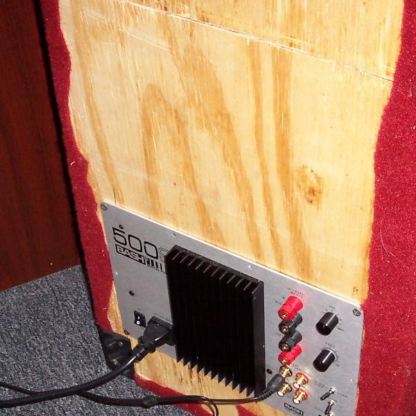

New member Username: Shawndecker1Pine hill, Nj Usa Post Number: 1 Registered: Apr-06 | I am currently acquiring everything I need to assemble my own home theater subwoofer. I currently have a surround system in use and wish to expand this system with a monsterous subwoofer package. What I need is a subwoofer amplifier that can handle (4) 10" 250 watt rms 4 ohm subs, wired either in series or parellel. I would like any and all recomendations on wiring and where I can find an amp large enough to pump out these watts. Max power would be rated at 1000 watts and I do have a subwoofer out channel from my Technics receiver, that is not amplified, hense the need for the sub amp. Can this be done? Running (4) 10" subs in one enclosure, wired as necessary for the ohm requirement of the amp? I've got the subs, ordered the grills, carpet, terminals, and will construct the ported enclosure soon. I'm looking for an output from this subwoofer that will make your heart skip a beat! I appreciate the help! |

New member Username: Shawndecker1Pine hill, Nj Usa Post Number: 3 Registered: Apr-06 | After searching, I can see many subwoofer plate amps available at 250w. Each unit is about $130. Can I find one that can power all (4) of my 250w rms subs at once using one input? Will I have to wire my subs differently in order to save myself buying (4) seperate amps? Am I missing something? |
Gold Member Username: Jan_b_vigneDallas, TX Post Number: 8226 Registered: May-04 | I'm not sure what you're looking at so I can't make specific comments but each should list power output at various impedance loads. Most plate amps don't care for anything beneath 4 Ohms so I would suggest a parallel/series connection if you only want to buy one amp. |
New member Username: Shawndecker1Pine hill, Nj Usa Post Number: 4 Registered: Apr-06 | Forgive me for sounding "newbie". How can I utilize my (4) 250w rms 4 ohm subs with only one amp? I've seen the plate amps out there and would rather not have to buy (4) 250w amps to power all my subs, in one enclosure. (Way too many power cords). I also don't want to spend $500 or more on the 1000w amps that put the power into one 4 ohm output. How to I handle this? Do I buy two 500w rms plate amps to run two 250w subs each, or do I need four 250w rms 4 ohm amps? I used to be good at this as I built several speakers in the past, just nothing of this caliber. Obviously I prefer one plate amp, is there one out there that can take a sub out signal from a receiver and supply 250w rms to each of my (4) subs? Tall order I know. Do I wire my subs to get an 8 ohm load and use two amps at a lower power? I'm seeking devine direction, as I'm pricing amps as we speak. Lot's of $$ in this issue, but what a package for justification!! A 1000w rms subwoofer, Jurassic park here we come! |
Gold Member Username: Jan_b_vigneDallas, TX Post Number: 8230 Registered: May-04 | I don't really understand your continuing reference to a "1000 watt sub". The "250 watt" rating of your sub means nothing. It is a suggested power handling spec but in reality is meaningless. You do not get a "1000 watt sub" by combining four "250 watt" speakers. The wattage of the system is determined by the amplifier, not the drivers. If you buy a 250 watt amplifier, you have a 250 watt amplifier driving four speakers. Speakers have no watts, only amplifiers have watts. To decide the correct hook up for your speakers I would suggest you decide which amplifier you want to buy and then ask the amplifier retailer how they suggest to hook the system together. They will know the limits of their amplifier better than I can guess without any idea what you own. You might want to place "parallel/series connection" in a search engine to familiarize yourself with what they are going to tell you to do. |
New member Username: Shawndecker1Pine hill, Nj Usa Post Number: 5 Registered: Apr-06 | I'm sorry for coming off too green. I really do understand the watts/receiver configuration, just that I haven't been into audio for quite some time and have no clue as to the where abouts of said plate amps. I have contacted creative sound and will be getting there advice. Back in "my day" if you had a 100w home stereo, you were God. Now I'm dealing with having to supply 250w x 4 of rms power to my subs and just wanted to know the best source. These plate amps are expensive, and I want to set this up right, once. Trust me, I know about those out there that think many of little is equal to a large, not me. A good clean 150w stereo will sound twice as good as (3)50w ones driving at the same time. Thanks again! |
Gold Member Username: Jan_b_vigneDallas, TX Post Number: 8246 Registered: May-04 | http://www.audioc.com/library1/links.htm See if that helps any. You can also contact Parts Express; http://www.partsexpress.com/?wt.svl=1 - They have been around for a while and have a very good reputation for quality and service at a resonable price. |
New member Username: Shawndecker1Pine hill, Nj Usa Post Number: 6 Registered: Apr-06 | I've settled on a Bash 500w plate amp, wiring all 4 subs in a series/parallel configuration. Everything from Parts Express: cable, amp, ports, ect. (Thanks Jan). I'm not close to my power cababilities but 500w isn't anything to ignore. This enclosure should be pretty heavy as well. It'll stand over 4 feet tall with an enclosure volume just over 6 cu ft. (Using the specs supplied by the sub manufacturer). 13.5" x 3" ports as well. I'd like to hear any other subwoofer projects anyone has put together and find out how they sound. I'm curious as to the overall performance a sub this size will sound, and feel. Good luck! |

Bronze Member Username: Shawndecker1Pine hill, Nj Usa Post Number: 11 Registered: Apr-06 | Just finished the box. Almost 5 feet tall! It was a little hard accomodating all the 3" vents in the design but I was able to manage to relocate two of the eight to the rear. This allowed me to use more of my front cabinet for sub placement. Added damping and sealed it tight, so to speak. I have never built a sub box this large. About 7.25 cubic feet. I added the extra cu's for misc hardware and construction volume, bracing, vent tubes, ect. Tomorrow I plan to start wiring it together. I'll series/parallel wire the subs and connect the 500w Bash plate amp to them. Looking for thunder, we'll see! |

Bronze Member Username: Shawndecker1Pine hill, Nj Usa Post Number: 12 Registered: Apr-06 | Finished everything and it sounds great! Sub is downstairs in the game room and the whole upstairs shakes. I tried uploading pics but this forum only supports small images. I kept getting error messages saying my upload exceeds 100k, my image was under 600x600, but, just over 100k. The box looks like something out of the back of a van but does the job. At 50% volume it rattled the dishes upstairs, sent the cats running, and even shook a few pictures off the wall! I haven't gone beyond that yet. If this sub gets old, and I can't imagine it will, my next will be 15's powered by the 1000w plate amp I should've bought in the first place. I'm looking to set the car alarms off two houses away! And yes, I did watch Jurassic park, one and two, and was shaken and stirred!!! Happy listening!!!! |
Bronze Member Username: Shawndecker1Pine hill, Nj Usa Post Number: 22 Registered: Apr-06 | Got everything together on the sub. Ran out of carpeting though and have the back bare. Im happy with it considering how it rumbles![]() |
