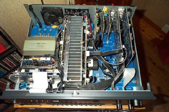

Bronze Member Username: Gatt767Malta Post Number: 37 Registered: Feb-04 | Look at the massive size of the NAD T762 Toroidal Transformer!![]() |
Silver Member Username: John_aPost Number: 718 Registered: Dec-03 | Great photo, Robert! |

Silver Member Username: John_aPost Number: 722 Registered: Dec-03 | The NAD T760 has a laminated transformer. I was quite wrong in saying it was toroidal. Apologies, Adam, Robert and others. I also find a small laminated transformer in the NAD T533 and T532 DVD-players. Here is the T760. ![]() |
Bronze Member Username: DocdatCopenhagenDenmark Post Number: 35 Registered: Apr-04 | No need to apologize John I wasn't sure myself until I had seen a picture of a laminated transformer, because the protruding copper shielded windings (not visible in picture) does make it look a bit torus-like in shape. |
Silver Member Username: John_aPost Number: 728 Registered: Dec-03 | Adam, Nice of you to say that, but there is no way that is a torus! I am doing a grip-on-reality check. I recently took apart and Armstrong 621 and my Sony power amp. They both have toroidal transformers. I'll spare you the photos! I also took photos of the T533 and T532 DVd-players. I included them in a post on the T533 thread to try to give a more sober review, but the browser crashed and I lost it all. I will try again later. |
