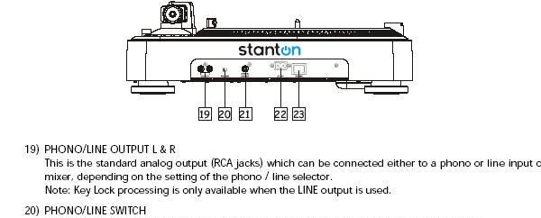

Bronze Member Username: TurbodogPost Number: 33 Registered: Jul-05 | I was able to download the manual. It keeps causing Adobe to crash on my computer, but in between crashes I confirmed that it has a pair of analog outputs, with a switch to select phono out or line out. It also has a S/PDIF RCA jack. So, if you correctly connected to the analog jacks, and put the switch in 'line out' mode, and correctly selected the input on your TV..... sounds like the turntable is defective. from the manual: This is the standard analog output (RCA jacks) which can be connected either to a phono or line input on any DJ mixer, depending on the setting of the phono / line selector. Note: Key Lock processing is only available when the LINE output is used. ![]() |
