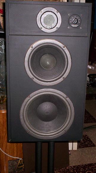

For anyone interested, I picked up a pair of unique speakers today.
Yah I know realistic speakers must be garb right, well that's what I figured
but there design and the price made me grab em ($3 for the pair used of'course)
Well they are a larger then normal 2-way (8" woof 3" tweet) with a 10"
passive radiator and they are also an attempt at being time aligned as the
top portion of the cabinet where the tweeter is mounted is set back about 2".
After taking them apart to inspect, a very intersting xover reveals it'self, the
woofer is run full range (no xover) and all the tweet has is 1 cap! Now if that
isn't a pretty minumal xover then I don't know what is. After checking them
out on the garage setup I see why they have no xover on the woofer as there
is no highs comming from that unit and the mids that are there sound great.
My guess is the 8" driver rolls off naturaly to a point then the tweet takes over.
From the limited testing so far this speaker system has some potential and I
am curious to try these on the 300B with some jazz and acoustical music
(as I do not see them being a loud/big rock speaker).
The extremely limited info I have found for these speakers so far (Optimus-40)
Power Input: 75 Watts Max
Frequency Response: 40 Hz to 20,000 Hz
Sensitivity: 89 dB @ 1 W/m
Wish I could get a phase and impedance chart for them to really try and determine if
weather they fit the mold of a "tube friendly speaker" but the simple xover and decent
sensitivity have me intrigued though, keep yu posted.
If anyone has some info I'm all ears!

No these do not look like those and I will post some pics later. They are
about 2.5 feet tall and about 15" wide with the top recessed back about 2"
where the tweeter sets they have a 10" passive radiator at the bottem then an 8"
woofer above that then a tweeter above that.

Username: Kegger
Warren, MICHIGAN
Post Number: 2634
Registered: Dec-03
Here's a pic and I've been listening to these for about a couple hours now.
Impressions so far is that they do voices wonderful both male and female.
Seem to have a little trouble with more complicated/busy passages of music.
Bass is very good, may be a tad rolled off at the top. They seem to like about
10-15 watts of power to really let um shine so yes they do stress the 300B a
little to much. But they do like the 40 watt single ended golden tube audio amp.
Need to play with them some more but what I've heard so far sounds much better
then some other speakers I've picked up recently not to mention others in the past.
Rolled off at the top may be giving the wrong impression as they don't really roll off
but more of they don't extend the frequency range as high as other speakers which
may make them a candidate for a supertweeter to extend there range a bit.

find things for myself all the time too and the price I pay is very very low. I paid $3
for this pair of speakers that looked intriguing to me, so to check them out I put
them through some of the gear I have to evaluate them. I would think many people
would envy the gear I have and the ability to evaluate something in a way that others
can not. When most buy something they have to hope it will work with there setup
even after all the research someone has done it's still trial and error that it works
as well as someone may think it will. Trying something in the store for a few hours
is very different then the home envirionment let alone to try it with many other pieces
to see where they work there best or even the quality of the gear.
So yes I have no problem picking something up that may be suspect if I get it cheap
and it looks to have potential so I can bring it home to evaluate it further for both it's
build quality and sonics comparred to many other pieces. (real world eval)
With the amount of gear I've worked on and used, the amount of info and knowlage I've
gained is unmeasurable and I for one feel very fortunate for this. Yes audio is a hobby
for me that I love so the more gear I get to use the better!

It's an interesting design is that a 12inc Bass LF driver with an 8inc Bass Mid and 2inc HF.
It's hard to tell by the picture, but I'm sure I'm close?
Username: Kegger
Warren, MICHIGAN
Post Number: 2650
Registered: Dec-03
Andy If you go to the first post it gives all the speaker sizes.
A very interesting speaker with great midrange and bass.
