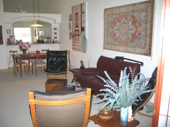

And - #4 here: hope these pics help you understand my room situation.

Just a quick observation. Is your carpeting wool or a synthetic fiber? If it is non-wool, lift all speaker cables and interconnects, if any, at least 10" of the carpet. If the carpet is a synthetic fiber it is acting as a mass of low quality insulation, that absorbs & smears energy from the field surrounding the wire. Try it, and tell me what you hear. I don't think it will solve your bass issues, but think it will help with any dullness/clarity issue.
What is the distance from the speakers to the couch? Also, what is the ceiling height and shape?

Rick: yeah, the carpet is orlon, nylon, or the likes. Don't know how I'll lift the cables that high - will have to take apart stands, connectors etc. to do it. But heck, I'll give it a try.
The couch is 12 feet out from the speakers, which are a little over 8 feet apart. The ceiling slopes upwards from 9 feet at the outside to 14 feet at the apex, which is over the area that separates kitchen from living room. You can kinda see some of the slope in pic #3?

Larry, my first question is, where were you standing to get pic #1? Do you not remember the sensation of things hurtling toward you at great speed? It's mostly the same effect when it is you hurtling toward the objects at great speed.
Be careful, sir.
You have the exact opposite problem most people deal with. For the most part people are dealing with a room that is too small to fit a 40Hz wavelength. Their room's reflections from the near walls on the sides are bouncing information around like a pin ball machine. In some cases their room has enough overstuffed furniture to turn a bass note into a dull thud.
You, on the other hand are trying to get your small B&W's to fill a shopping center. You are getting no reinforcement from side walls and corners, You get very little reinforcement from the ceiling, and what you do get is not consistent due to the sloping height. The wall behind the speakers is not tall enough nor long enough to act as an infinite baffle to bass frequencies (which means any soundwave that is longer than the wall is long or tall will wrap around the wall and try to fill that space also). Though the reflection coefficient of the rice paper is lower than that of the glass windows, the rice paper still reflects virtually all the frequencies which arrive at its surface (it just does so unevenly). This reflection adds to the high frequency emphasis of the room. Your wall hanging behind the sofa is rather, well actually, all but totally ineffective in damping reflections from the back wall that is a few inches from your ears when listening. (It can be made more efficient by lowering it about 1',moving it about 4-6" from the wall and placing damping material behind the hanging surface.) Even moving the cloth out from the wall is minimal since the material will still absorb unevenly and reflect most high frequencies. The floor covering is not thick enough to damp the reflections of anything but a bit of midrange. It is also all but ineffective in sustaining a bass note. (Is there any padding underneath?) Well, this is just going to depress you if I continue. You get the point, I hope. Your room is a, read "the", problem. It is no wonder you describe the sound you are getting as thin and at times piercing. (I would suspect the little Polks breathed a sigh of relief when they no longer had to pull yoeman's duty in that space.) The larger problem is what to do about it without incurring the Wrath of Mer (and costing chunks o' cash).
Despite having a space that is the exact opposite of most problem rooms, the constant of room treatment says the solution is exactly the same as every other room. No matter what the space, the solution to the problem is a selective mix of reflective and absorptive surfaces. Whether everything in a space leans in one direction or the other, the lopsided effects are going to result in poor sound. Until a room has the corerct mix of surfaces, the sound quality will be compromised. How much can be done to correct any room is a matter of choice. I won't tell you a subwoofer will not put more bass energy into the room (obviously it will), but the problem of the room will persist.
Unfortunately, the solution to your problem will be more difficult to find in the existing literature. Since most people deal with a room that is too small, most written material deals primarily with that aspect of room treatment. That doesn't mean the answer isn't available. It does mean you will have to read and understand a bit more. I've dealt with your type of room before with clients who live in modern or hacienda type spaces. You might want to call an acoustic engineer in the area and ask for recommendations on reading material, they might have something helpful - or not. You might ask at the audio shops in the area that deal with the same type housing on a regular basis, they might be willing to help someone who has purchase all their gear online - or not.

Larry - I would send your photos along to B&W. They appear willing to help and will have dealt with this problem before. As to the speakers having "enough" bass when the volume is raised, it is simply a matter of the amount of acoustic power that is required to energize the space the speakers are working into. Think Double Klipschorns! Think Voice of the Theater. Think JBL Paragon!!! (Actually take a look at the Everest picture.)
For now think soft surfaces and boundary walls.

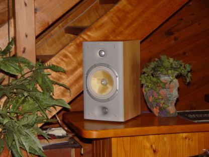

One more point, Larry. Take one of the grills off a speaker and hold it up to the light. Notice how much light comes through the cloth. Now, anything that doesn't allow that much light to pass through the weave of the cloth will begin to reflect the sound at higher, not lower, frequencies. Absorption and diffusion is accomplished by passing the sound waves through sucessive layers of material that eventually dissipate the energy. Absorption cannot occur if the signal is reflected off the surface of the material. No light, probably no absorption. Lots of light, the sound can simply pass through to be reflected off another surface and pass back through again. Lots of light in successive layers = absorption.

Oh, brother - I go away to solve another crisis and come back to find I've got an impossible room-situation on my hands! Sigh & GRIN.
Had to take the car to the shop (again) power steering decided to die. $500. Need I say more?
With Big Scotch in hand, I pen: Well, thanks for a LOT of information - some of which I guessed, and some which comes as news to me.
first, I cannot move about the stereo set. The in-wall wiring for the surround sound - and the cable TV antenna - are both located behind the stereo cabinet. It's set in stone. Soooooo. . .
I'm going to TRY to persuade Mer to get some more soft-stuff on the walls. But - the BIG chair-picture on the wall I'd like to "treat" was painted by her - you get the message.
As to the grill cloth - it covers only the woofers, the tweeters have a thin wire mesh cover. Strange, but inside the cloth woofer-cover there's a lot of criss-cross plastic pieces. I'd think that fewer of those would help pass through the sound - but of course I can't touch them! NO CUTTING! no,no,no,no,no,no,no,noooooo.
Let's see - under the rug there is foam padding. And aside from that - I think I'm stumped. Sigh. How about if I go out and buy a huge blanket - hang it over the speakers, and sit under the other end of it as I listen? Might work. . .

You should just be able to pull the grill off. You don't neet to cut it. They do come off. You can put it back on.

Here's a couple of things I noticed in regards to your room that may create problems based on my readings:
- your furniture is mostly wood and leather (more reflective than cloth furniture)
- a lack of boundary walls to the sides of the speakers
- large expanses of unbroken surface on the long walls
Here are some practical things that might help in regards to some of the reflective surfaces (but don't know if these will help the bass problem.)
- Instead of building a permanent dividing wall between the dining/living areas, setup a bank of short bookcases. They can server two purposes: Use them for storage and for displaying bowls, sculptures, etc. - but, they will also act as a reflection diffuser.
- Add throw pillows to the sofa and add a fabric throw to the back of the sofa.
- Add big leaf plants in the corner near the sliding glass door and in front of the japanese screen.
- Put decorative bowls or sculptural pieces on your coffee table to break up the reflective surfaces.
- On the long wall behind the TV, change the grouping of your pictures and add decorative enclosed shelving. Do the same thing on either side of your Persian rug over the sofa. An example of the type of shelving is here:
Decorative Shelves
- You have those beautiful speaker stands...but, as a test, try putting the speakers on a 4" block of maple wood and put those brass cones you talked about under the front of the speakers to tilt them back. When I had my Mac in the bedroom, this gave the MA's and the B&W's a much bigger/fuller sound without the use of the sub. I believe someone on this forum indicated this might yield a +3db result?
- Build an attractive acoustic treatment to place on the wall behind your equipment and speakers. Check out this article for instructions on DIY room treatments for around $100:

Larry, I saw one suggestion of hanging canvas art works instead of framed pictures with glass/acrylic faces. Fill the space behind the canvas with acoustic treatment such as styrofoam covered with fabric.
So, it seems there are quite a few "practical" options available to you in making your room a little less lively.

Larry - The point of having you pull the grill off was so you could hold it up to the light. I really don't care whether the woofer or the tweeter have a grill cloth or oatmeal on them. If the material you are using for acoustic treatment doesn't let the sound pass through as it does with grill cloth, the material you are using will reflect the sound. The wave has to pass through the outer layer before anything other than reflection can occur. Japanese rice paper panels are not going to let information pass through. Therefore, the Japanese panels and the wall hangings are reflecting the sound. That is the reason for asking you to look through the grill.
Mer's picture is reflecting the sound, but it has little consequence to what you are hearing where you are sitting. What you are hearing more in your listening position is the wall 6" from your ears.
Before you put the for sale sign out in the yard, the good news of your room is the long distance to the side walls and ceiling will give the first reflections from these points much less effect than more conventional rooms. This typically can benefit the imaging and the soundtaging of the system. There's what you have to look forward to. Add the sub and possibly the amount of energy you will be able to put into the room will be sufficient for low level listening as well as high volume.
You are right. Do NOT cut the little plastic pieces. They are not interferring with the sound. It's sneaky at those frequencies and knows how to get out on its own.

The Oriental rug over the sofa is deep-pile wool, and absorbs sound very well. I hung it that high so that people with greasy hair didn't get it all messed up! (grin)
Jan - you are right about the rice paper - but it's use in studios and homes comes in with it's positioning - in V-shapes so as not to directly reflect sound, but to deflect it. Our main studio for radio in Chicago had all-wood walls - but they were cut into V and semi-circle shapes, so that the sound did not directly reflect.
We're thinking of putting a sorta "free-form drape" of fabric up the sides of the sliding glass doors, and draped over the top. It will be decorative, not real "drapes." Will help the liveness, I'm sure - but not a lot.

After watching your room picture I think that may be I was wrong and there is a point in adding sub to your system.
Your room is very big with high ceil and open space to kitchen and other rooms.
The B&W 705 are small speakers It is probably beyond their ability and power to fill such a big volume.

Username: Myrantz
Post Number: 1412
Registered: Aug-04
Larry - you axed for it: rear-left

My Rantz - hey, ole chap, them thar's purty nyce speekurs! Yep - and from a smallish listening experience of my own, they sound Smooth! You'll surely have a fantastic music experience with those, sir! Congratulations on a choice well made. And THANX FOR THE PICTURES!!!
Mer adds that she's enchanted by the art-pieces she sees in the pics - and also the wooden staircase. Makes us both homesick for the big wood staircase we had, and loved, when we lived way, way up in the Colorado mountains. Sigh. You've got a pretty neat house, sir! And congrats to Ms. Rantz, who's obviously in charge of "home enhancements!" Good taste, there, lady!
