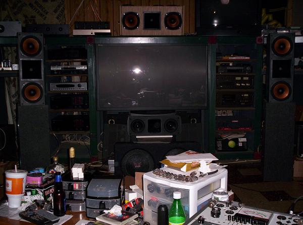

Gold Member Username: KeggerMICHIGAN Post Number: 2261 Registered: Dec-03 | To the original question on this thread! "I've been looking on the net for people's thoughts on what to set your receivers crossover at, what what to set you speakers to small or large. THX recommends all set to small and 80htz. And some others say setting your mains to large is good. (If their frequency can handle it) What has anyone tried and seen any differences?" It all comes down to the size/capabilities of your speakers and your taste for bass. If you want to get "propper" and have smaller speakers also, then by all means set the xover to 80hz and adjust the sub output to level. That's the easiest setting. It gets more complicated and more taste driven when you have large and small speakers then throw in your center which probably doesn't go that low. You should try varying settings and see what works for your system/room and suits your tastes. If you have giant front speakers that go down to 35hz or less "without being down 6db" Then I would set them to large and the rest of my speakers based on there size/capabilities. I generally tend to use medium size speakers on the rest of the system with large fronts and center channel. My center channel has 2 8" drivers and a big horn http://www.klipsch.com/product/product.aspx?cid=365&s=specs Which says it goes down to 45hz so I set my fronts to large and everything esle to 55hz as to cut the other speakers off before they bottem out and let my subs do the rest. Now I run a prepro with all seperate amps that are mated well to each speaker they provide power to. But some have hinted towards the idea that if your running a reciever it can be beneficail to your reciever and your speakers to set the xover at somewhere around 60 to 80hz and let the sub take over. That has some merrit to it as bass uses much more power from your reciever to produce more heat and strain the unit so unloading some of that work onto the sub can yeild very desirable results. "ADDING A 2 CHANNEL AMP TO YOUR MAINS CAN WORK ALSO" ___________________________________________________________________ As to some of the larger speakers of yesteryear. I have some thoughts as to why you don't see them anymore and that actually ties into this threads beginning! Most of what is bought and sold these days is home theatre with a reciever "trying" to power 5-7 speakers in 1 unit! that's asking a lot of a piece of gear. (back in the day you had 1 big amp with 2 channels) So by building these recievers the smaller speaker came about to accomadate them .Then the sub was needed to fill in where the smaller speaker left off. If you go into your high end shops that sell your macs and krell's then you'll see the larger speakers associated to the "larger" gear. As paul mentioned look at the b&w 801 nautilus (incredable speaker) but no reciever is going to power those babies, you need a dedicated amp and no one but the extremely rich is going to use them as home theatre. So if you want a stereo system versus a home theatre setup and shop at the dedicated 2 channel stores you'll find the big amps and big speakers but there even more expensive then before as not as many people shop for those anymore. They want small and cute to go with there furniture instead of there furniture being there system. I have probably 10 to 15 pairs of speakers and some date back to the "large era" cerwn vega D9's yamaha dj speakers with 15"drivers "like the vega's" epi magnus a24 with dual 12" drivers All the above will blow the doors off the house without much to stand in there way. And that is fine if that's the sound you want "I do occasionally" But as of the past few years I want a more refined and cleaner sound then those can offer so I also have some b&w and jm/labs speakers that when setup right and powered by good gear can sound amazing with incredable imaging and detail but lack that kick of the old giants that I own and love. I've been able to find a middle ground that works for me and that's JBL AND KLIPSCH. No I'm not talking the JBL AND KLIPSCH from best buy and such but the reference or upper studio lines from these manufacturers. (And they tend to be of the larger variety) To me they give little up in all the catagories but cover more than most. And the best atribute for me is there very effecient , some extremly! "not much power needed to drive them" And that's great as recently I've gotten into tube audio gear which generally have lower power than solid state but make up for it in the finer points. There are trade offs pretty much with every speaker and setup you go after. The best thing to do is get the setup that does more of what "you" like but remember there are others out there who have different preferences than you, and your setup may lack to much in the areas they find important! I have found my NIRVANA! TUBE GEAR WITH KLIPSCH SPEAKERS! Still a work in progress but isn't it allways! ![]() |
Gold Member Username: KeggerMICHIGAN Post Number: 2262 Registered: Dec-03 | Paul: "If my speakers somehow died(they never will since they're indestructable, unlike the botique brands), " Actually they can I've blown my 20 year old D9's a couple times. Tweeters and mids! Doing Dj work or playing parties really working them! You'd be suprised at the power handling on the reference series of klipsch. I should know I've blown many a speaker in my day from jammin! |
