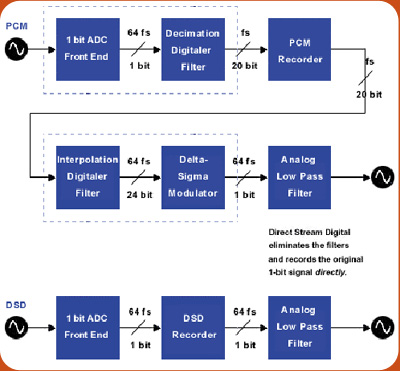

New member Username: Modul8trPost Number: 2 Registered: Dec-04 | DSD is Direct Stream Digital. The technology behind SACD's which captures WAY more info than a CD. Apparently it is much closer to the original waveform of the music than CD which is somewhat interpolated. It's a less complicated process than PCM (CD). Therefore much more of a "Direct Stream" of the original source material. So no, he was not referring to the Pioneer, but rather SACD technology in general. ![]() |

Gold Member Username: MyrantzPost Number: 1192 Registered: Aug-04 | Yes DSD (direct stream digital) is the SACD format. On some players (like the Denon 2910 & 3910) you can set the speaker delays for SACD but it will be converted to LPCM so true SACD sound will not be emitted. True DSD is an option on these models for the purists but then correct speaker placement will apply for maximum enjoyment as the delays will be ignored. I am not sure about the Pioneer models - I know some have true DSD decoders. |

Silver Member Username: Arnold_layneMadridSpain Post Number: 279 Registered: Jun-04 | This was debated here earlier this year, conclusion was that DV-578 converts DSD to 88.2 KHz/24 bits PCM (per channel) before sending to DACs. In case you wonder, 88.2 is used instead of 96 KHz because its a more even number when converting DSD (88200 x 32 = 2822400). Cheers AL |
