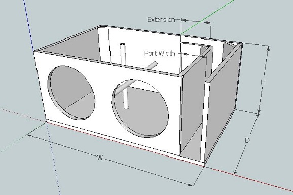

So my box outside dimensions I'm making is 15" height, 40" wide and 19.5 inches deep using 3/4 mdf comes to 5.41 cubes with one slot vent at 4.5" by 13.5" height gives me 60.75 square inches of port area, to get a tuning of 35 hz according to the12volt I need a port length of 18 inches, now I understand all that , what I'm trying to understand is does the 12volt think that' 5.41 is the internal volume after the port displacement or before port displacement , is my port displacement only 18" by 13.5 by the 3/4 mdf to get like .1 cubic feet plus .14 for two subs plus .1 for bracing 8 4" triangle pieces, total of .34 displacement. Or is the port displacement 4.5" by 13.5 by 18" which is .63 cubic feet plus .14 for subs plus .1 for bracing total of .87. What I'm trying to figure out is what will my total net volume be after displacement and exactly how long do I need to cut my slot port lengrth to get 35 hz after all the displacement values, Sorry if I confused you but thank you for your help, just trying to get as close as I can to 5 cubes. 60 square inches of port area and tuned to 35 hz

Assuming you have a trunk car, the following can be done in the dimensions you give, 4.5 net is good, usually building a cardboard box is necessary to make sure the actual box won't get stuck in it's way in, set the amp subsonic filter to 28Hz.
Enclosure Specifications:
Fb = 35 Hz
Vb = 4.5 ft^3
External Height = 15 in
External Width = 40 in
External Depth = 19.625 in
Port Width = 4 1/2 in
Cut Sheet List:
* All Dimensions in Inches.
* Wood Thickness is 3/4 for all Parts.
External Enclosure Parts:
Front = 34 3/4 x 13 1/2
Back = 40 x 13 1/2
Left & Right Sides:
Side 1 = 18 1/8 x 13 1/2
Side 2 = 18 7/8 x 13 1/2
Top & Bottom = 40 x 19 5/8
L Port Internal Assembly Parts:
Front to Back = 13 5/8 x 13 1/2
Extension = 1 3/8 x 13 1/2
Username: Raidernation87

Looks sweet!!! Thank you for that . what type of material should I use or works best for the internal bracing you got going on in that design, looks like I'm going to get that amp after all, thank you for all your input I have an old kenwood kdc252u head unit I'm going to install also, nothing special just something to get me through till I can get a better hu, looking to get either an older eclipse hu with at least 5 volt preouts or an older model pioneer premier with the same, haven't been around car audio since about 2006 when I first was introduced to this forum when guys like you and glass wolf were on here a lot so kinda lost when it comes to newer and quality head units. I'll�let you know how it turns out when I get it all installed. Pretty pumped to finally get it all going

1 1/4" wooden dowel rods which you can get @ home depot, you can have your linear cuts done there for free, use wood glue and drywall screws to join the parts, and you will need a jigsaw for the sub cutouts.
