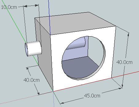

I just built a box to my subwoofer.
The Subwoofer : https://docs.sony.com/release/specs/XSL121P5_mksp.pdf
The box is 45 * 40 * 40 cm.
I used chipboard, 2,2 mm.
I want to place a tube in the speaker, how long and what radius should it have ?

Sub is recommended for sealed use,will not sound nice in a ported box but anyways, a 4 inch diameter port 28 cm long would tune you to 34 Hz.

You will never get great performance from this sub but you could try once more, I guess you meant that wood thickness is 22 milimeters, in that case to tune to 33Hz you would need to do a 40 cm (10 cm external) length port as follows:

Thank you for the good respons, I will try this out, and see if it get worse/better then before, wil write how it goes here, if anyone elsis interested
