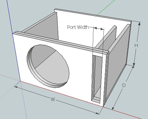

What I need help with is finding a good amp for the this sub and getting a custom ported box built that fits in my trunk.
I want to go with 8 Cubic Feet for the box size but am not sure about what company I should go through or even where to look. Any help with that would be very much appreciated.
The biggest square area in the middle of my trunk is
43 and 1/2" Long
23 and 1/2" Wide
and
24" High
Trying to calculate 8.0 cubic feet I came up with these dimensions for my box without the wood thickness added in
43" Long
23" Wide
14" High
Is this a good starting point for any box builder? I'd like to help whoever can build this as much as possible but I don't really know what i'm doing lol.
If you'd like to help and want more info just reply and i'll post back.
Thanks in advance to anyone willing to help!

If you can do 24 high, do this:
Enclosure Specifications:
Fb = 35.1 Hz
Vb = 8.2 ft^3
External Height = 21.5 in
External Width = 43 in
External Depth = 23 in
Port Width = 5 in
Cut Sheet List:
* All Dimensions in Inches.
* Wood Thickness is 3/4 for all Parts.
External Enclosure Parts:
2 x Front & Back (3 parts) = 43 x 21 1/2
Left & Right Sides = 20 3/4 x 20
Top & Bottom = 43 x 20 3/4
L Port Internal Assembly Parts:
Front to Back = 14 1/2 x 20
Assembly guide (generic dimensions):
- All trunk boxes built outside the car need to fit in their way in not just have the right dimensions.
- The port needs 5" of free airspace in front of it for proper operation.

Thanks man. I might build it myself if I can figure out how to do it properly.
Username: Joe1234
Post Number: 1778
Registered: May-09
You're welcome, I will give you some tips to succeed:
1) Build a cardboard dummy box to see if it fits perfectly in the way in and if you can close the trunk lid without problems.
2) use Titebond II wood glue and MDF/Drywall screws and once it dried apply silicone caulk to avoid any potential leaks.
3) you can get your MDF wood cutted at Home depot, just need a jigsaw to finish the job.
If you have any questions let me know.
