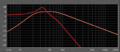

Alpine 1243 red a 4th 2:1 1.75 sealed Ported @38Hz (on red), Ported 2 cu.ft @33Hz (on orange) both after standard cabin gain.
Myself, I will be glad with ported.
Still I can fix the 4th by lowering the ratio but then my gain is gone and prob I have wasted space.

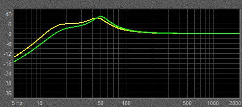

LH here is a comparison sealed (1 cu.ft) vs ported (1.8@37) for the Autotek m12d4 before cabin gain:
Both are recommended settings by Autotek.

Here is the response for the M12D4:
Yellow @30Hz green@37Hz both at 1.8 cubes cabin gain factored in, looks kind of crappy, still it will hit though.

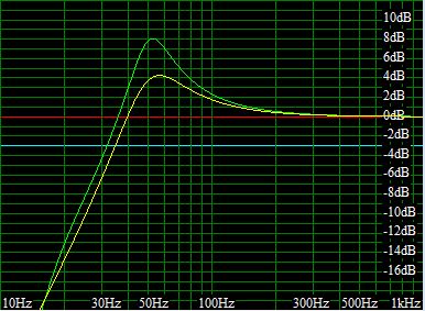

On top is the Autotek, both in 2.25 @ 35 and the second plot is 2.5 @ 30.
https://fbcdn-sphotos-a.akamaihd.net/hphotos-ak-ash3/542445_10151002922020786_60 0705785_12886899_730434221_n.jpg

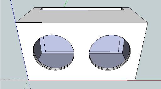

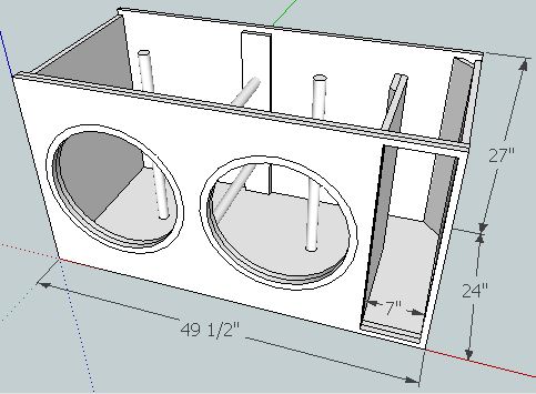

The box that I could realistically build, without technical problems, is 49.5 x 26.5 x 23, 1.8 cubes per sub, then I'd build the port on top unconventionally, I'm thinking kerfed fiberglass. I can't fit 26.5" high closer to the back so there would be a curve with the roof. i hate measuring curves. i have a feeling im going to spend a lot on wood. box sitting on carpet over rubber matting over metal, floor filled in with foam/wood on top and then the sides of the box would sit on it. how does that sound? when the console lid opens and gets in the way theres still 1" clearance from box to lid and seat. 26.5" is right at the top of the head rests. It's the perfect box. How would I go about securing that if I weren't going to bolt it? heavy duty straps?
Username: Joe1234
Post Number: 1500
Registered: May-09
With the box size you mention, I could get about 13 cubes net with a 12.4 sq.in per cube port tuned to 37Hz) and I used 0.05 cubes displacement for each of the eight m12s, the 8 drivers barely fit on the 49.5 x 26.5 surface. If you are running the port partially external then maybe above 13 cubes.

I got 14.4, double baffle, .08 for subs displacement, adding .08 for every motor cut out (which makes up for the displacement). Sonic emailed me and said they were out of stock of Autoteks. They suggested Power Acoustik P1 12's for 55. i dont even know how to build the floor up, all i can think of is foam. this is becoming a headache. ill do a back seat box instead with different size subs.

outside 48 x 23.5 x 27
port 3.5 x 46.5
13.5" port per cube
12 @ 34

In the middle of the car, after the box height (with 3.5 x 46.5 port) is 7" to the roof. Without the port, the sealed portion would be 22.75" height/outside or 11.25" to the middle roof.
I was told to make the port the width of the box. Now I have to angle it?

I've never done a box with a 13:1 area form factor, I was always curious if design rules go too far in some cases. The rationale is friction which increases with a larger contact surface, a square port having the least (after a round port) for a given cross-sectional area.
Also if you are talking about a turn corner.. the port does not turn, doesn't go near the back wall so if I understood right.. no.

The lower BL is for the same reason as the lower Fs on a larger sub. Move moving mass. The sensitivity would be similar since both probably use the same motor structure and magnet, though.
On the ports, if you do go with a slot port, and you do have a turn or bend, try to have it kerfed. I prefer round ports with chamfered edges or flares, but I'm more of a SQ guy. SPL doesn't do anything for me.

I meant the port. Too tired to think atm. No, the port wouldn't turn. Box depth is pretty much port depth.
I'm going the simple route, slot port on top.
I could have the port kerfed. So I should be using a more square port? Sure, I could make it go higher. This will help get it into the fuxing car. I'll build the port inside and leave the baffle off till it's on. That way I can screw it in without folding myself into weird places.

So why should I get the 18 (red 6@32) instead of the 15 (yellow 3.75@32) standard cabin gain accounted for:
The 18 just seem to dump more energy into the subsonic region but will not be louder to the ear. Neither it seems a very loud setup overall. Just crazy low.
If I am undersranding right this is about what you intend to do, I just changed the symmetry of the port a bit but it can be done in a number of different ways.
Fb = 34 Hz
Vb = 11.7 ft^3
External Height = 27 in
External Width = 48 in
External Depth = 23.5 in
Port Width = 40 in
Port Height = 4 1/4 in
That sort of port type tend to flex badly so a center brace front to back would be useful, just rounding the edges of both port ends would be enough as long as port area allows for lower airspeed.

I'm looking at Fi SSD 18's now, starting at $254, flatwind $15 (dunno what that is), cooling (30, dunno if i need it), internal lead (25). I'll use a good 2K amp, 1 batt, 200ish alt or whatever I need. 12 cubes @ 34 Hz.
Joe, could you model these 2 18's in 12 @ 34 after cabin gain? I'd like to see what the price difference is. The BL with options comes to $414.

Box has changed to port on the drivers side, vertical. I keep reading that it meters louder. I got 13 cubes NET @ 32.75 Hz w/ 2 18's. I could also do 8 10's or 6 12's or 4 15's (in 3-3.25 cuft).
Username: Joe1234
Post Number: 1517
Registered: May-09
Here is your previous request (12@34):
As always the BL(yellow) can't take advantage of it's higher sensitivity at lower frequencies so is more suited as a SPL driver tuned higher.
On your second post, well port on the driver's side, the driver gets to predominantly listen the output of the port..
Lastly bear in mind that more drivers more $$ 4 15s on 13 cubes depends on the drivers..

Like this?
A little paranoid bracing..lol

doesn't look too bad and might be flat after cabin gain. 60 hz is right at the 0db point so thats good. thats all i need.
Joe, can you show me that after cabin gain? vs 3 xcons ported 12 @ 32.65 Hz port 25 x 5.75 port length 20.375
3.12181654 cubes
.42
31.3 hz

working on final box dimensions. im bracing it well with 2x4s and wooden dowells. port 6 x 27, 12" of port per cube, 13.5 NET @ 32.425 Hz.
Username: Lord_huggington
Ontario Canada
Post Number: 616
Registered: Oct-10
making it 15 cubes net @ 32 hz now... building port inside car. oh well. sweeeeet.

so the box ill put through the door is still 27 x 24 x 49.5 but how do i build the port - can i use just glue? actually, i could screw in the port walls at the sides through the sub cut outs. problem solved. i still need to measure for port area. dual chamber so the port ratio is decent.
im trying to make a cut sheet. obviously sheets come in 48" and the box is 49.5" so im going to have to make it a little differently.

Shop guy measured the door. It'll be angles, angles, angles. A bit of a horn style port. Wont have to build the port in the car this way.
2 batts, hopefully odyssey 2150's. ill run the amp at 4 ohms for now, until i can get the elec. done.
Something like this, about 13-14 cubes @ hopefully 30 Hz.

Here is a sealed vs ported (standard cabin gain included) for the cheap Pioneer TS-W3002D4
The boxes are 1 cube for the sealed, 1.6 for the ported, at tuning frequency you get 14.4dB over baseline while on sealed 2.50 a 11.9dB difference at tuning! I bet it would peak harder tuned higher, not very linear though
The only thing sealed have going for it is performance below 22hz which is substantially higher than ported. A feature that would share with 4th order bandpass.
