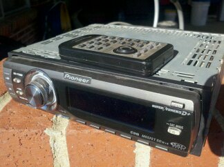

Silver Member Username: MakinblakMonroe/Monticello, La/Ar Post Number: 787 Registered: Oct-10 | I had this Pioneer cd player a few years back and someone borrowed it. They returned it not working at all. I freekin loved this HU, the knob on the driver side moves like a joystick and the inface is ergonomic, facilitating quick adjustments. Is there a company that can at least give me a quote on fixing it? Cuz I don't want to buy a new one. And it"s sentimental. |
Silver Member Username: MakinblakMonroe/Monticello, La/Ar Post Number: 788 Registered: Oct-10 | Here come the pics...... |
Silver Member Username: MakinblakMonroe/Monticello, La/Ar Post Number: 789 Registered: Oct-10 | ![]() ![]() |
Silver Member Username: MakinblakMonroe/Monticello, La/Ar Post Number: 790 Registered: Oct-10 | And is this thing worth fixing? I feel like it is an awesome unit, but I'm kinda dumb on HUs |

Silver Member Username: MakinblakMonroe/Monticello, La/Ar Post Number: 792 Registered: Oct-10 | it doesnt do anything. at all. it might as well me a brick. What do you think? |
Gold Member Username: Joe1234Post Number: 1037 Registered: May-09 | Well if not even lights come up the first thing to check is the harness, make sure that voltage gets to the deck's terminals. both switched and unswitched voltages and ground, the next thing to check are the connection terminals from the deck to the back of the faceplate faceplate, checking that they are not dirty or bent. If everything seems ok I would say get rid of it since there is no easy way to tell for sure if the faceplate electronics also sustained damage. A common issue was a broken ribbon but it would take opening the HU which I wouldn't do without any experience on servicing electronics. Those older late 00' Pioneer HU were great sounding.. and there are hundreds of them for sale so you might want to take a look on CACO.. also lovely is that the guy was kind enough to take the time and return it... blown.. |
