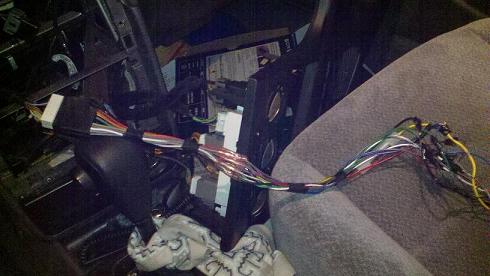

Update, Replaced the audio/dome light/other fuse, and the dome light now works. The HU will now accept and eject cd's, but the lights dont pop on. I took some pictures, and also looked up the original wiring diagram. found here http://www.the12volt.com/installbay/forum_posts.asp~TID~95926. I'm confused with what to do, the turn signal fuse is fine, although they won't turn on for some reason. Pictures coming.

Username: Vc23
EastCoast, Michigan Dos Fi BLs
Post Number: 374
Welp, the deed is done. Got everything back together, everything is working. Don't ask me how.
