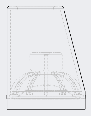

Silver Member Username: AlonzoubPost Number: 316 Registered: Apr-10 | So basically I just wanted to get some opinions on the use acrylic to make a window to look inside a box. This project may or may not even happen depending on my friends time/money situation in the next couple of weeks. Its going to be an Alpine Type R 10" v2 in a sealed .6 cuft box. It is going in a (forgot the year) Dodge Dakota Quad Cab and will be getting 300-500wRMS, The box is going to go between the center console and the rear seats and will be down-firing, I forgot to take pictures so I hope you can visualize what I mean. Basically we wanted to make the box a bit showy by cutting a rectangular area out of the top and replacing it with an acrylic sheet with blue LEDs inside the box. My question is... how thick of acrylic would be necessary to prevent vibrations, we are hoping to keep the cost of the project to a minimum which is why im concerned. The size of the "window" is going to be about 5 3/4" x 9 1/4". Here's a 3D mockup so you can better understand the situation: In this pic you are looking at the front of the box (up against the back of the center console) and the top that will have the window: Front of the box and bottom, subwoofer downfiring. Side view. ![]() |
