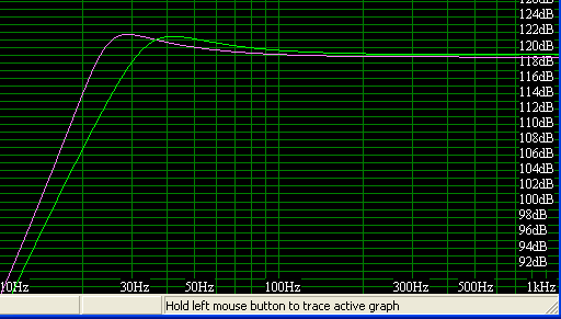

Silver Member Username: Joe1234Post Number: 863 Registered: May-09 | And there are your 2 CVR 6cuft@25Hz (on Violet) against the single L5 6cuft@30Hz (on Green), The L5 is able to match the loudness of the 2 CVRs but the CVRs will go lower on that huge enclosure. So in many cases the subs are not the problem, it's the size of the enclosure. |

Silver Member Username: Mash4kashLafayette, LA Post Number: 367 Registered: Feb-06 | I understand the 2nd chart better joe since I'm familiar with the 92db and up. Where do I stand now with the 2 cvr's in the .88 cu ft each ported @ 36hz on that 2nd graph? |
Silver Member Username: Joe1234Post Number: 864 Registered: May-09 | You are peaking at 52 Hz, not much deep bass but better than the kenwoods I guess. The problem is the box but adding polyfill will lessen the lump. |
