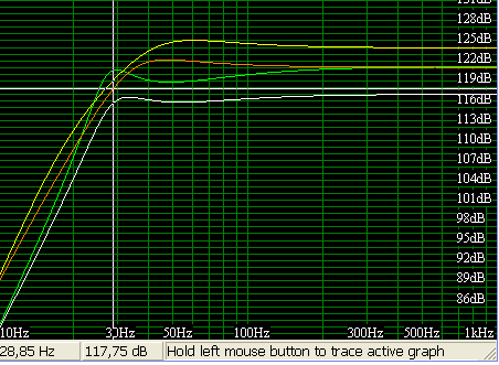

Silver Member Username: Joe1234Post Number: 779 Registered: May-09 | So I was expecting that.... LOL, a single SSA XCON 15" will optimize on a ported 4.0 cu.ft. @ 26Hz will get you those deep lows you want, again with flanged pipe ports you can save considerable space. A 15" Fi Q will do as well in a similar enclosure size. This is an excellent SQ sub as well. Both are viable alternatives the SSA will probably hit lower and louder, need to take a closer look at both. I am sure these will fit your car, BUT exchanging rides for this would only show LOVE.. LOL. |

Silver Member Username: Joe1234Post Number: 780 Registered: May-09 | The XCON is rated at 1750W RMS and will take 2K so the 2200 is still on, output will be comparable to the 2 iDMAX but I will model both later to get that in proper light, There is still plenty SQ on the XCON to like, the lows are stellar on high quality 15"s. If you want to sacrifice some output and extension, the Q may be better for SQ. Now really hope you can take measurements carefully, maybe something bigger can fit, with accurate data is easier to make suggestions, estimate output and else. |

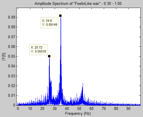

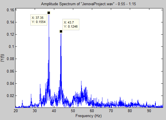

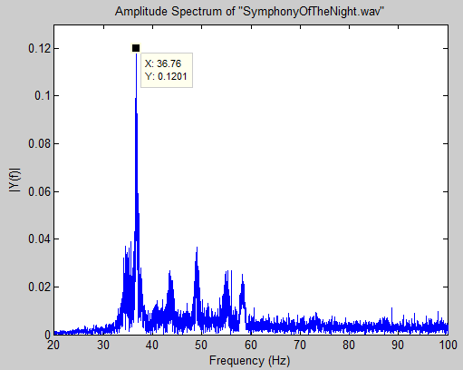

Silver Member Username: AlonzoubPost Number: 269 Registered: Apr-10 | So it took me a little bit to get the MATLAB code right... but Im 99% sure I got it. At first I tried to run the code on an entire song... but my computer gave me a memory error and proceeded to lock up. So for every song I chopped a 20 second clip where I thought the bass was pretty strong. Heres the results of the three songs you asked about. You may say... "damn thats kinda weird that they ALL have a peak around 44Hz... there must be an error in your code!" Well in order to verify I took a song that was edited by a guy named DECAF on the stevemeade forums. This guy edits rap music by slowing it down and cleaning up the bass to make good show-off songs. He also notes the peak frequencies in his songs... I chose a song called "Kafani - Feelin Like (35, 26)" The 35, 26 are his noted peak frequencies... so to check that my code worked correctly I would expect to see 2 peaks, one near 35 Hz and one near 26 Hz... here is what I got: If you have any other songs you want me to try, feel free to ask. |

Silver Member Username: AlonzoubPost Number: 270 Registered: Apr-10 | All the stuff DECAF makes is available on this thread: http://carstereoclassifieds.org/forum/showthread.php?t=304 The song in that screenshot is in Zip #25 and is called "Kafani - Feelin Like (35, 26)". Honestly this isn't my genre of music, out of the 100 or so songs I have downloaded of his... I have only found 1 I actually liked, but a few of them are bareable enough simply because the bass sounds so low and clean. As far as the ones you asked for, Borgore-Guided Relaxation Dub didn't really have a single frequency that stood out, I may have missed a part of the song that had strong bass because i kinda just skimmed through them. Heres the results: If you want me to do anymore, It would make it easier for me if you told me a 20 or 30 second section to analyze, for example just gimme the name of the song and say something like 1:00 through 1:30 or something. That goes for anyone too lol, MATLAB is a program I use for school and any practice I get with it is a good thing for me, I don't mind doing these. |

Silver Member Username: Joe1234Post Number: 784 Registered: May-09 | Ok, the XCON lives happy in big enclosures and low port tuning not so the vast majority of the subs. I think that nothing more than a tape measure will be necessary to get your dims, one important thing is that sometimes the box fits but it gets stuck in it's way in. FeelinLike(goingBoom).wav LOL.. try that one on an improperly loaded sub!! |
